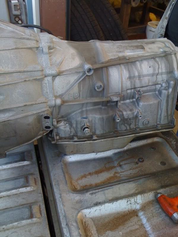

i already have a 6l80. would i not be able to reuse my bell housing and output housing?
pic:

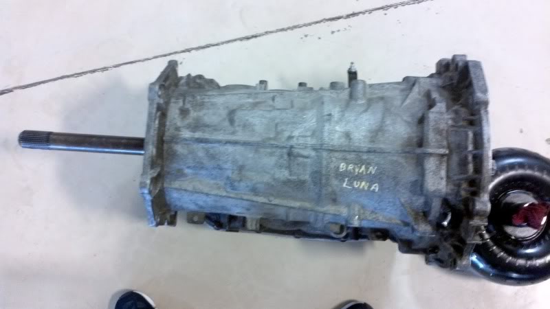

That transmission doesnt even look close to your transmission. Doesnt the vettes still use a tube? I know the converter has a different bolt pattern than ours.
Truck/car center section an bellhousing is the same. The car tailshaft/output shaft is different from the truck version
I think it'd be better to just buy something that's designed for your truck.

Transmission in a vette is located in back of the car and not directly mounted to the engine.
At very minimum you would need Bell and tail housing, probably would need to change the input and output shaft also.

Does the mounting plate on the back of the Vette transmission unbolt? It doesn't look like it will allow a normal rear truck mount to work.
Old Jun 4, 2012 | 12:09 PM
iamkeniff's Avatar
Posts: 5,365
From: Gonzales, la
The bellhousing and tailhousing would be way different. The OD of the trans vs my trans looks to be smaller OD on the vette than my 6L80e
