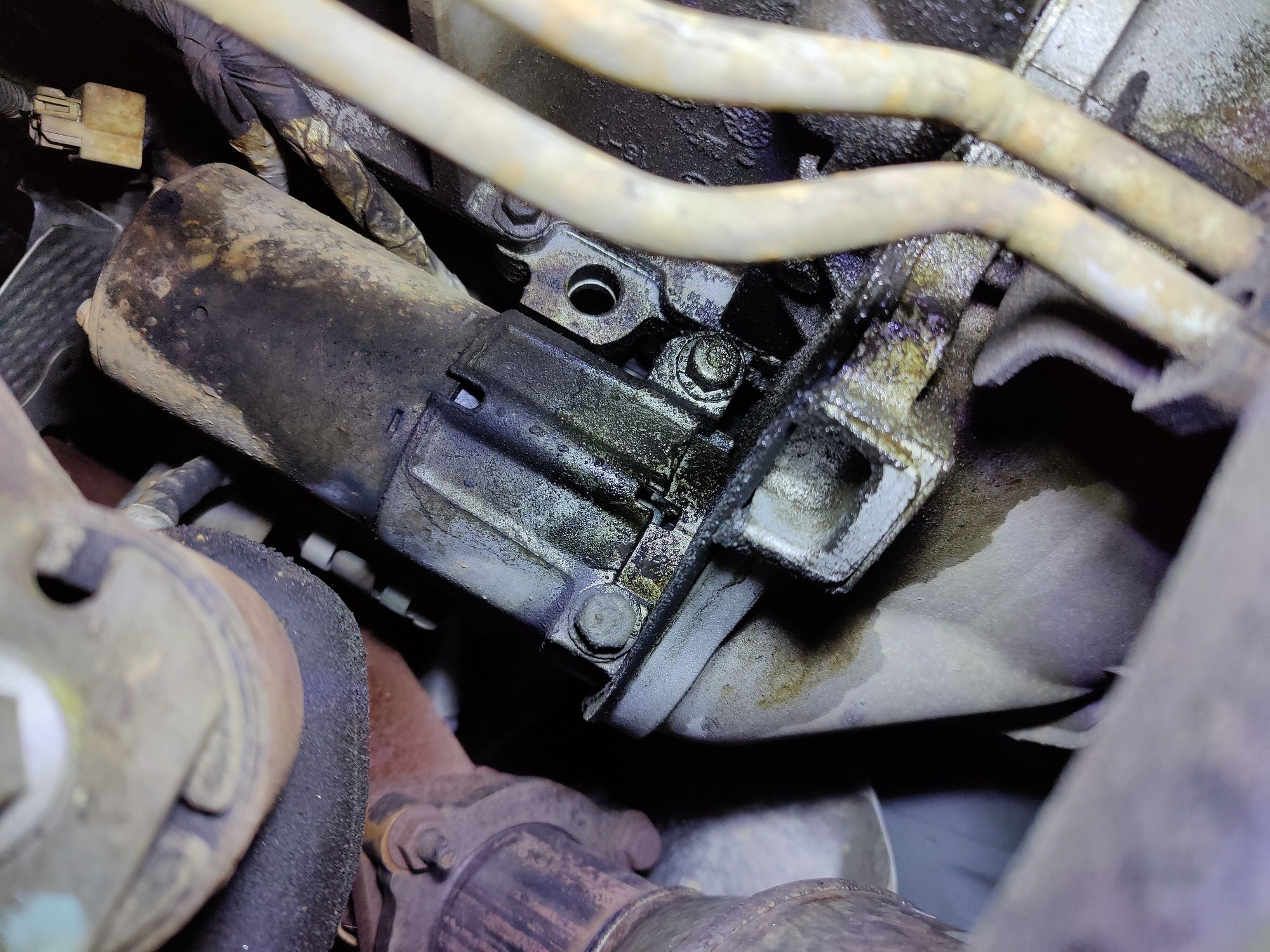

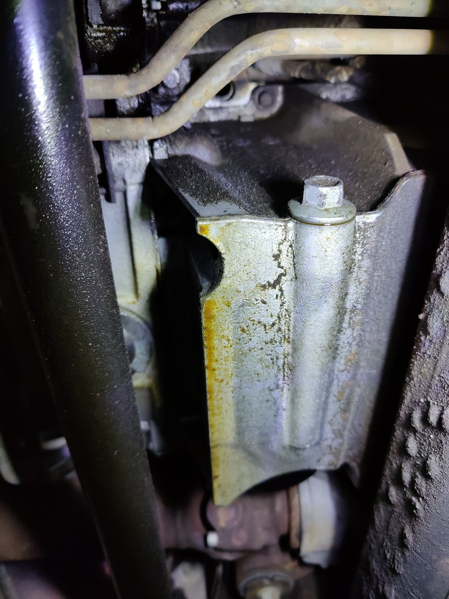

So I got the whole new oil cooler line assembly with both lines and a new block and after crawling under the truck and seeing transmission fluid on the transmission cooler lines, power steering pump to gearbox hose, and all the rest of the oil sprayed all over the transmission pan along with the red transmission inspection cover on the bellhousing and seeing oil everywhere along the bellhousing and on the starter side as well, I just decided to give up and knew struggling with putting this new line on just wouldn't be worth it at all.
I think I need to just pull the whole entire motor out. This would let me be able to get to the transmission cooler lines and actually take them out since I don't think I can reach them and get them out without either pulling the motor or transmission out. This would also let me take a good look at the back of the motor and see exactly what's causing so much oil to leak from it or fix it if its the rear main seal or rear cover or something like that. The best part it would also let me put a cam and 706 heads on.
This should also let me get to the steering box and change it way easier along with the lines and power steering lines. I feel like pulling the whole motor out isn't as hard as I always thought it would be?

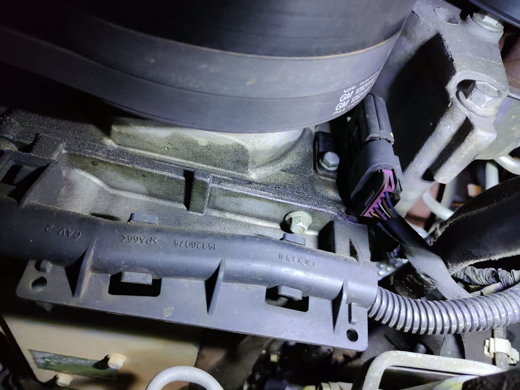

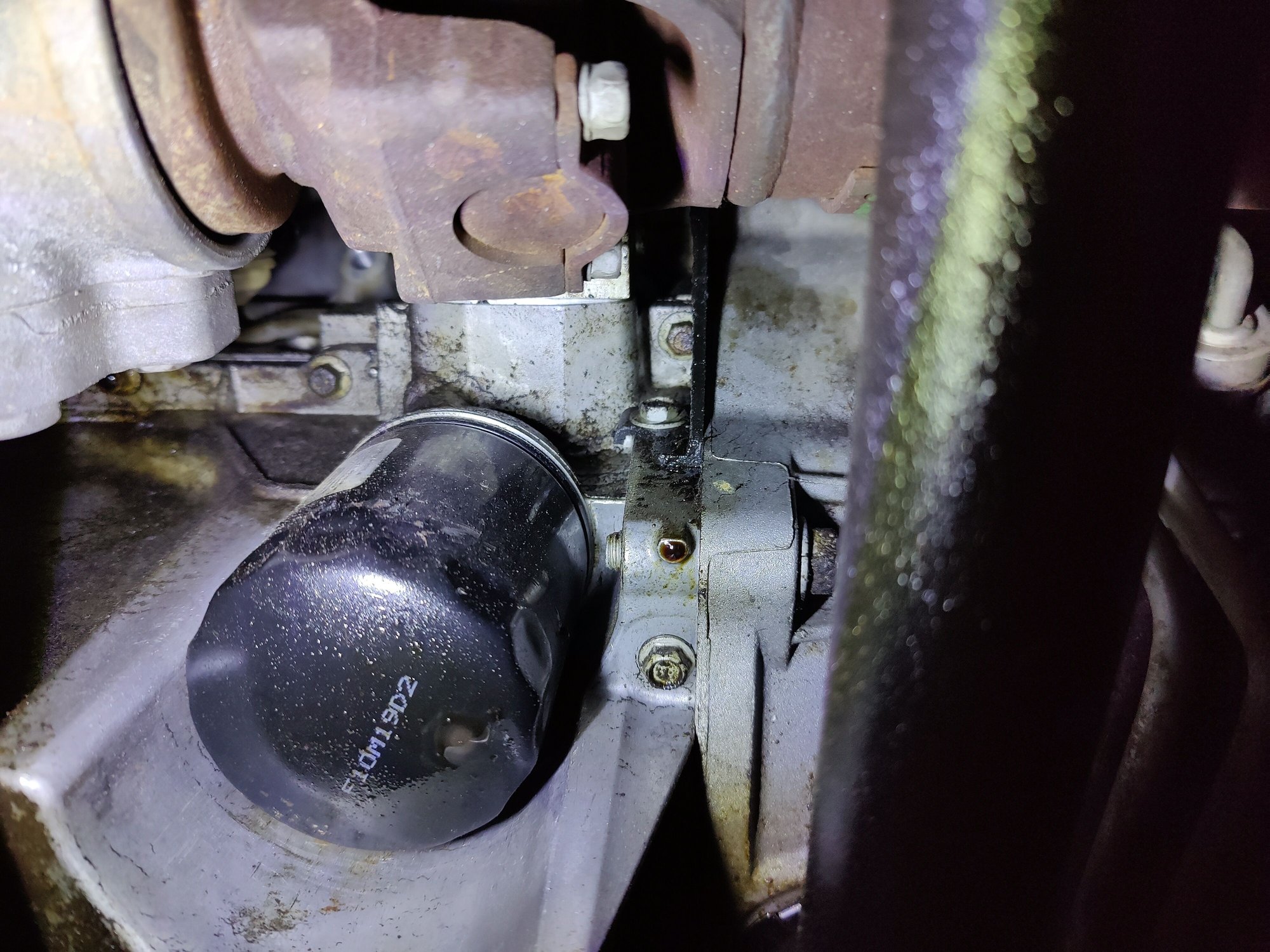

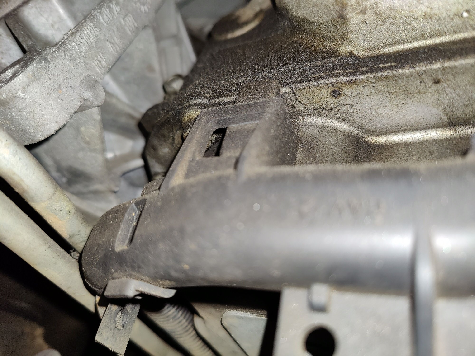

How long does oil continue to drip (yes that's a loaded question) ... Trying the easy stuff first, I have changed the valve cover gaskets, the o-rings on the camshaft and crankshaft position sensors (using the ones on eBay that are supposedly the correct ones), and the oil pressure sending unit. I also resealed the oil cooler blockoff plate. I still have some oil dropping from the bellhousing (I think) and some still getting on the starter bolts, though the side by the crank position sensor seems to be not leaking ... so I am wondering if I just have a ton of oil in the bellhousing looking for a home ...
Interestingly, the bottom of the engine is pretty damn clean except for the dripping off.

It can drip for quite a while or at least show to be wet.
One drop of oil can spread out to a quarter size spot pretty easily so it doesn't take much.
If you haven't done an oil pan gasket do one of those next, they are notorious for leaking
