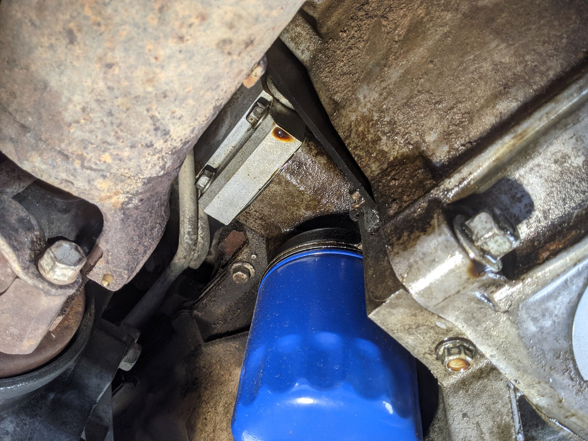

I was thinking about trying a plasticer, not sure how good they are in oil though since it gets changed, or if they absorb into the seals good. I could never really prove a leak or prove no leak from my cam sensor, it sure dosen't seem like its coming from it or the oil pressure sensor.
I climbed back under today to look, the leak has apparently made it all the way down to where there is wetness on the bottom of the transfer case and transmission pan:

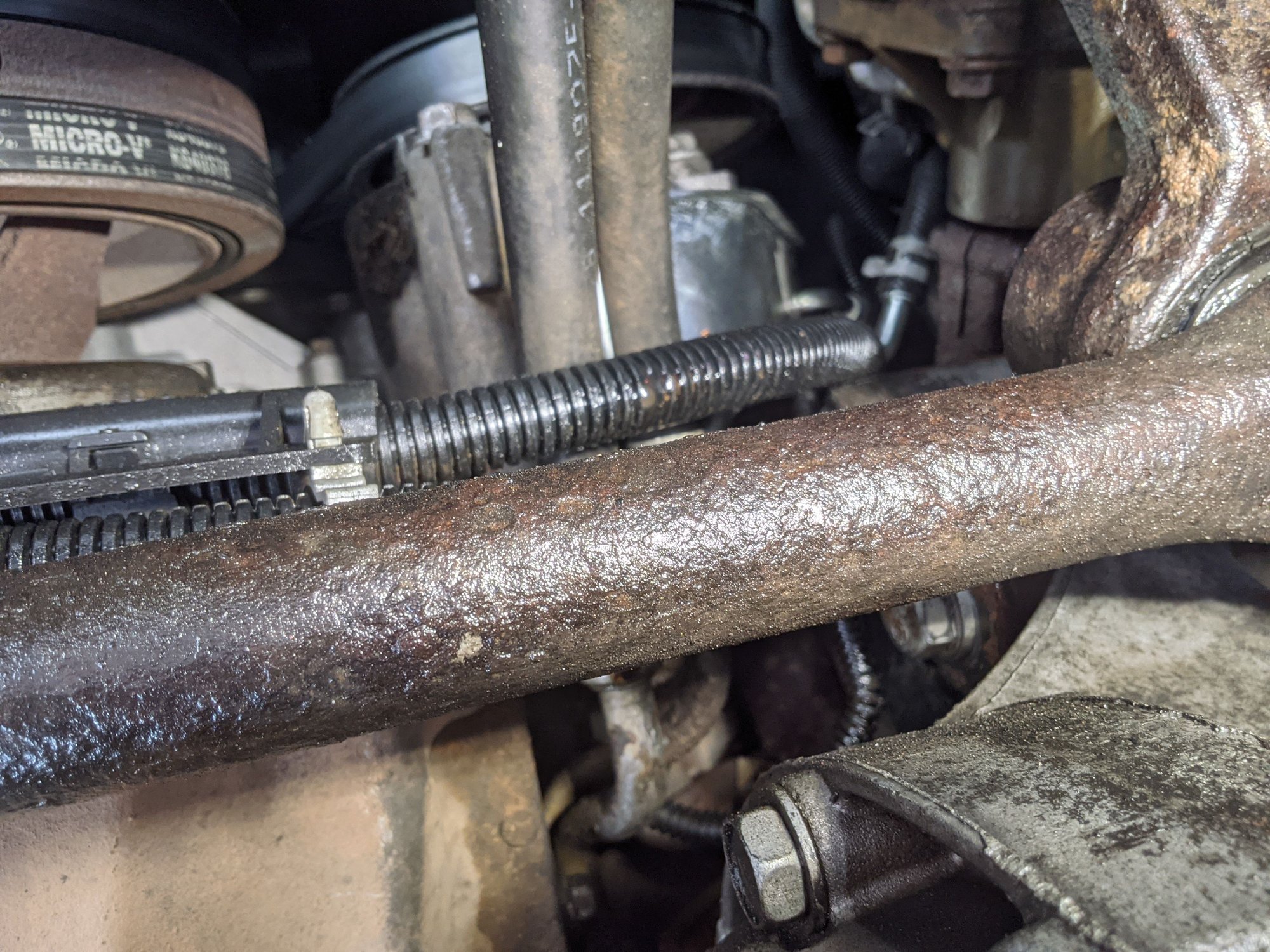

While looking at another thread, I saw someone say "90% of leaks on the trucks is the oil cooler lines", and from looking up under I think they might be right. Even on the ends of the power steering lines and other places where engine oil shouldn't be, like around the transmission, there is engine oil. Maybe I should try to invest in some new oil cooler lines. I do believe up front the oil on the steering bar linkage is power steering fluid from the steering box, its still hard to put your finger on it and smell it or tell if its engine oil or power steering fluid or transmission fluid.

Well you will read all over about the crimp fittings on the coolant/power steering/transmission lines being garbage and leaking. They all use that same style crimp connector to hard pipe, and notorious for leaking at those connections.
