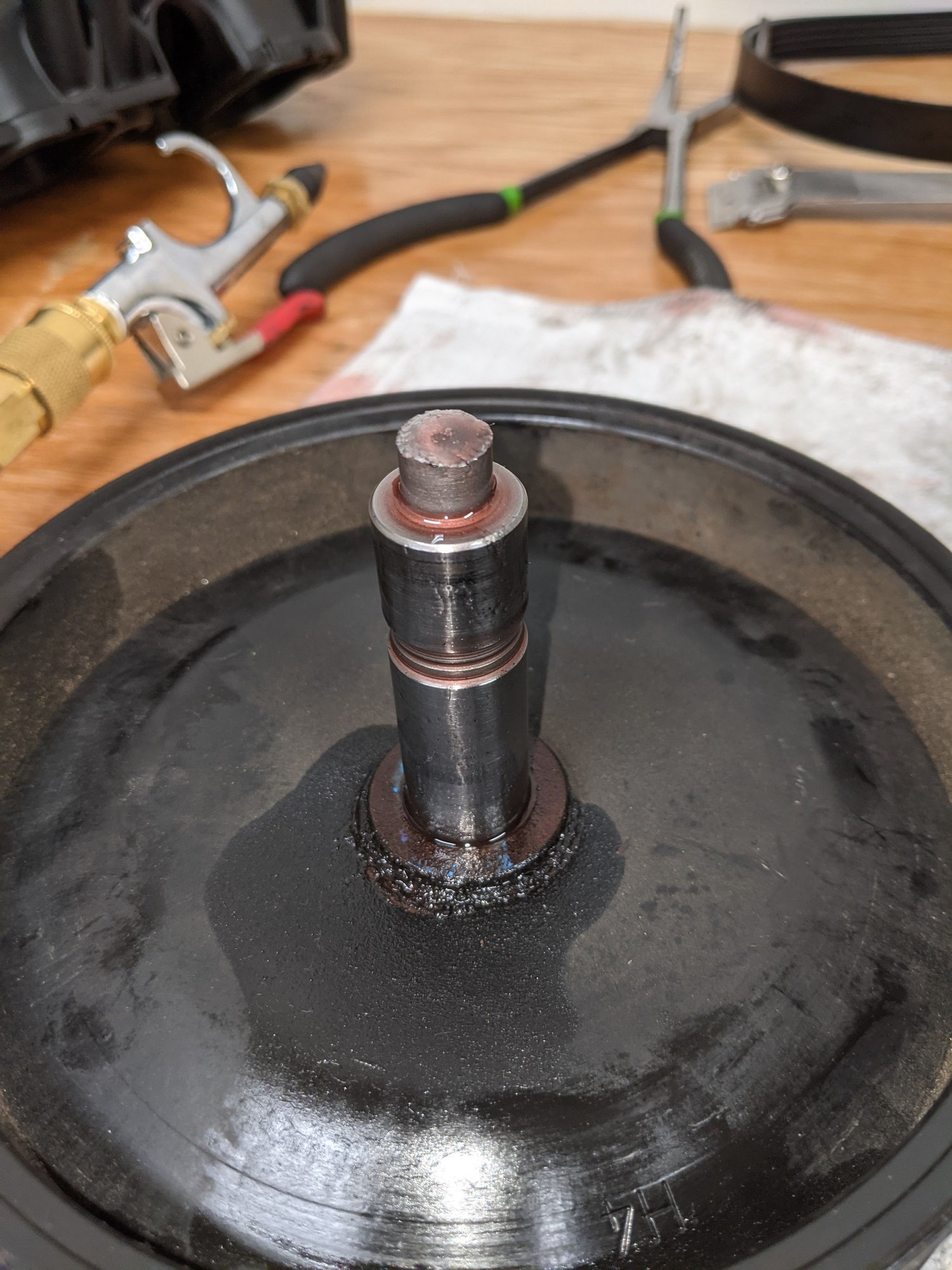

Edit: Ok got ahead of myself and wasn't' even paying attention, the shaft is snapped, I can tell it wasn't a torsional fatigue failure either, so the pump got overloaded when I brake boosted it.
So the pulley is just spinning inside the pump. A little fluid was also leaking, but there is so much everywhere I can't really tell where the source is. There were drips at the bottom of the pump and reservoir, so I figure some could be leaking from the pulley shaft seal. I am pretty sure the pulley spinning on in the pump is a common issue, especially when you have hydroboost (I believe this issue happened when I was brake torqueing the motor, so I was hard on the brakes and revving it up). This also explains the belt issues and noises, maybe the shaft is too worn down and its wobbling the pulley and making belt noises as well.
I should have learned my cheap reman/aftermarket parts lesson by now, I put this pump on about a year or so ago. I also had a 2005 Duramax that I think had this exact same issue with the pulley just spinning inside the pump.
Also I believe the pulley is supposed to be pressed off another shaft? It looks like the pulley remained on the shaft its normally supposed to be pressed out of, but the internal shaft in the pump came out, which I don't think is supposed to happen or is supposed to be pulled out that way?
