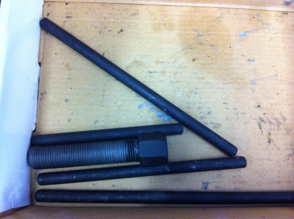

I decided to install my 10% OD harmonic balancer today. Well I thought I was going to... Long story short, I broke a puller trying to get it off. Is there a specific puller that I am supposed to be using? I just had a 3 jaw puller and thought that would do the trick.

just texted my tool guy and had him order me one of those pullers. thanks for posting up the part number AK

So, on the ATC puller does that rod just bottom out in the crank to pull off the pulley? I had originally removed it with a harbor freight pulley, but this time it wouldn't budge. I hope that rod is strong enough. I assume it will bend.
