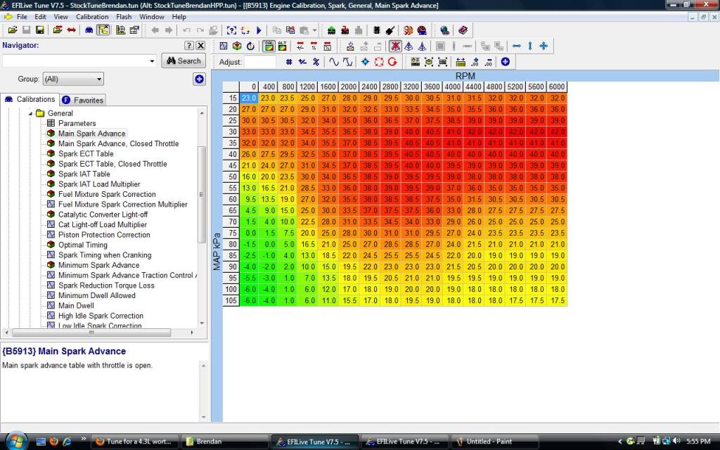

Wanna see what a HPP buys you on a 4.3.... Attached are stock and HypeTech tunes from the same truck (A Low Dime's truck). The only change is added timing, and PE leaned out by 0.1...
Stock
HyperTech

From: Minneapolis, MN
Maybe the '97's are different. I'm not saying it's a 100% difference, but I bet it's a 5-10% difference. At least on my truck it was. I at least selected the 160deg thermo setting assuming it added more timing along with the 93 octane tune. It still hits 128 mph. Pretty impresive for a little V6 in a 4100 lb truck

From: Fort Worth - TX
I dunno man, i was not doubting you or anything, maybe brendan's was different but when i first downloaded both from his truck it made me laugh... His is a 2000 s10
