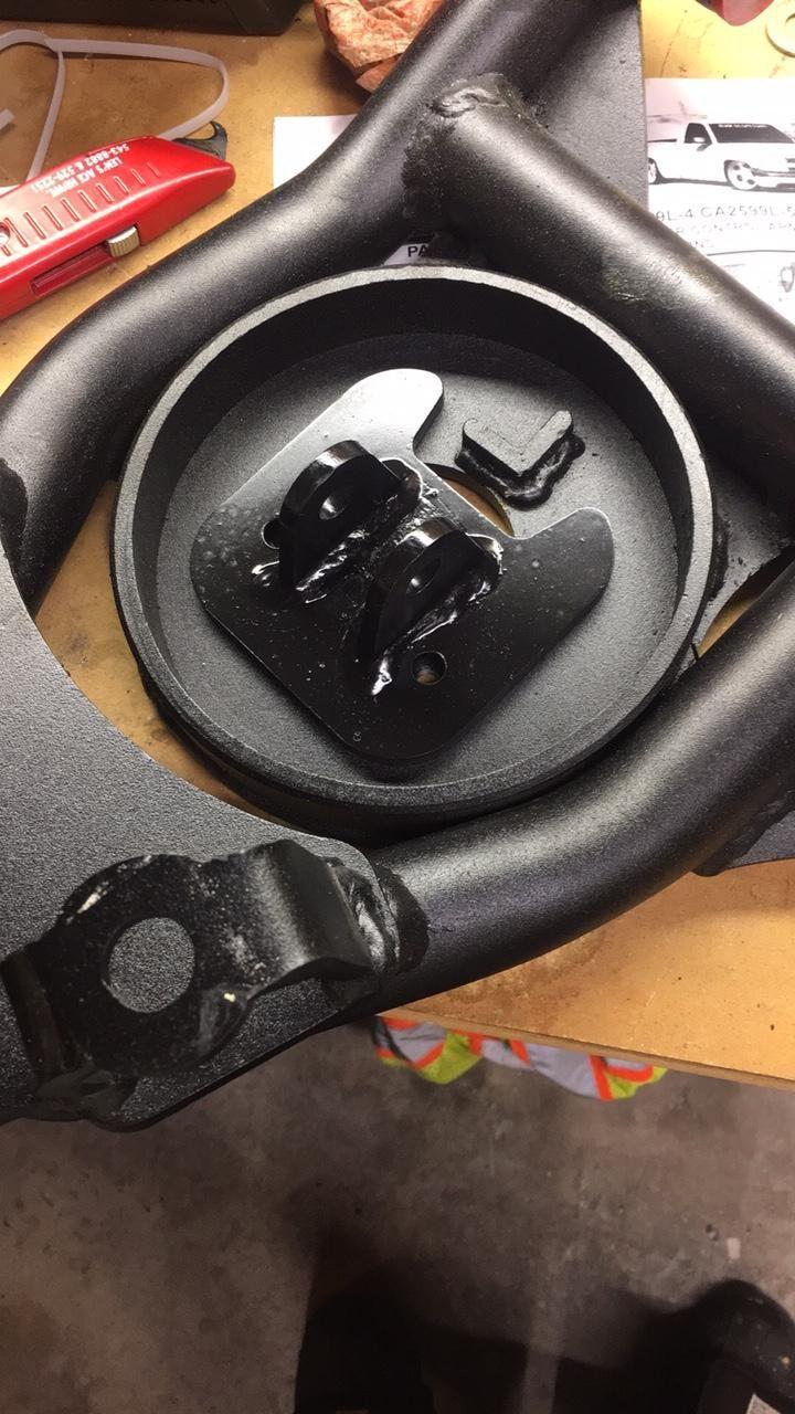

after asking around i picked up some qa1 DS301's, Atomic brackets, 4" djm arms, flip kit, C notch and for out back VA specialties shock relocation kit and qa1 single adjustable shocks

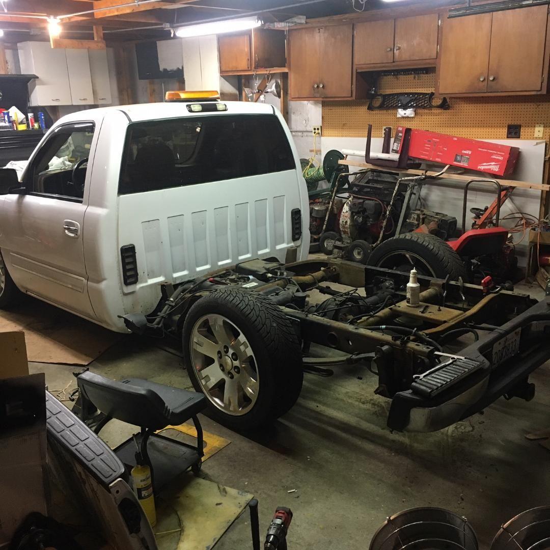

pulled it in a my cousins garage and got to it
every thing went pretty smooth was zipping along
put the wheels on put it back on the ground and well it was like a 6" drop way to lower then i wanted

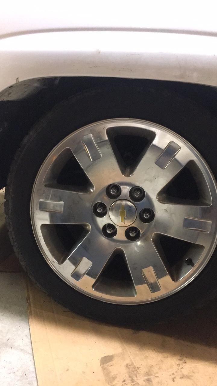

adjusted the qa1's some and was able to bring the height up a little its probably around 5 or 5.5" now still lower then i wanted i got 15" from wheel center to fender keep in mind tires are 245/45/20

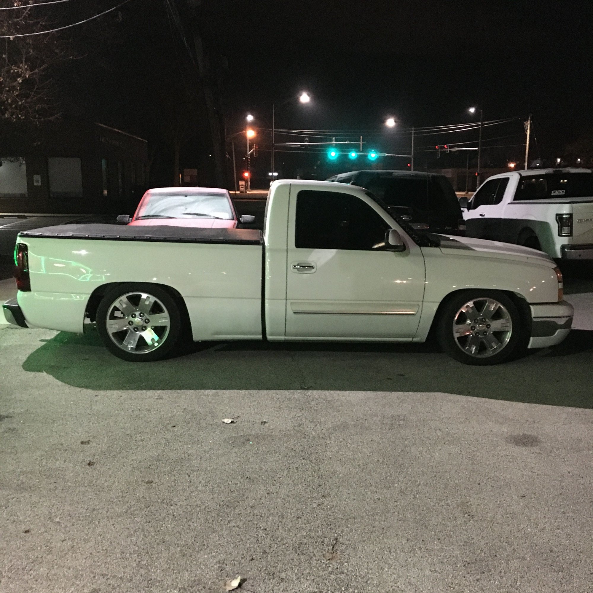

finally got it back together and put about 80 miles on it, this thing is way way to low for me! for as low as it is ride is not bad i have not adjusted any thing set front to lever 6 and rear to 4 both need to be firmed up a little most bumps are not bad but hit a couple that put the frame on the ground and got a little tire rub up front (ouch!) going to bring the front up 1" with the qa1 extender eyelids and the back 2.5" with a 1.5 lift shackle in place of the installed 1" drop shackle hoping that gets me where i want to be
currant drop after it settled.... slight cali lean

I think it looks good like that

yeah it looks pretty good just dont like bottoming out the frame and pulling in my driveway i scrap something so going to take it up a little
