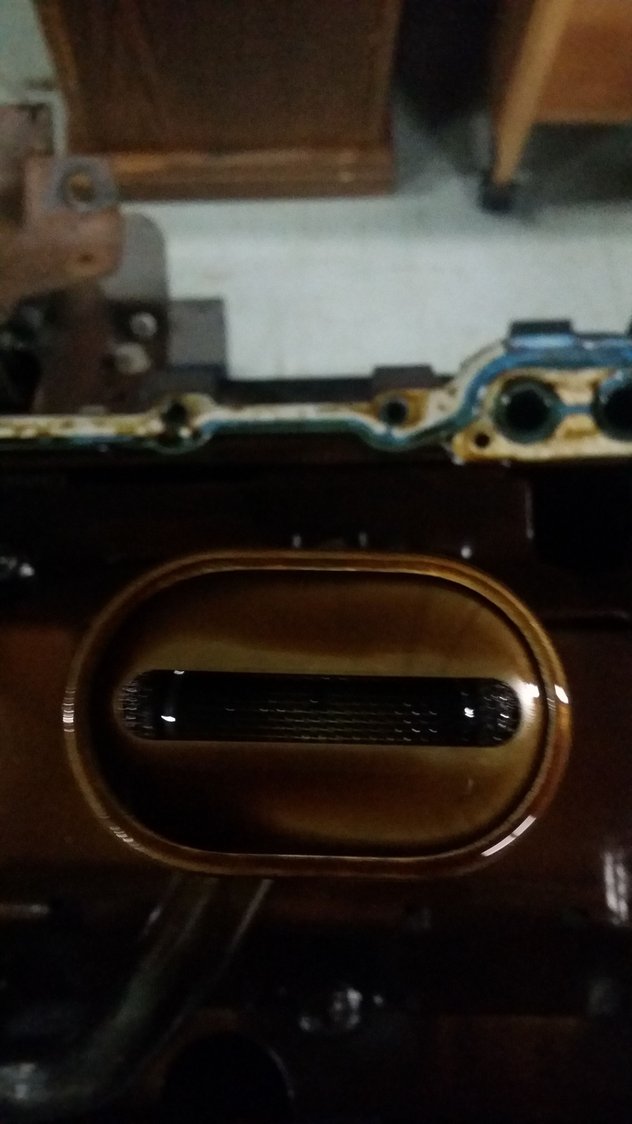

Is that stain in the middle an issue??i can feel it rise
Old Jan 15, 2016 | 11:56 PM
  #22
FFDP's Avatar
Joined: May 2014
Posts: 5,282
Likes: 600
From: Rogers, MN
It's like oil build up over time.
If you hot tanked the parts it should come off.

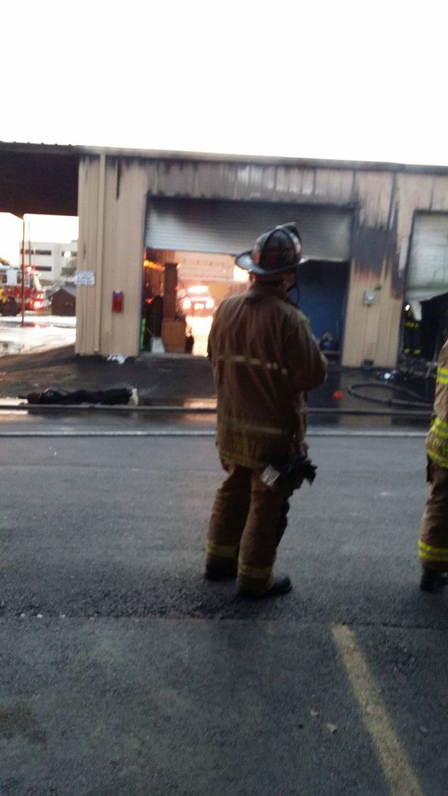

Would of been to the machine shop earlier if not for 2 alarm fire
Old Jan 18, 2016 | 08:19 PM
  #26
Wolftrk99's Avatar
Joined: Jun 2013
Posts: 5,492
Likes: 48
From: Virginia Beach,VA
Holy crap!!! Was that the machine shop???

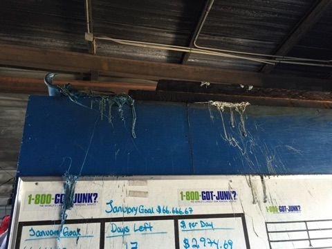

Looks like a scrap building judging by the quota on the wall.
