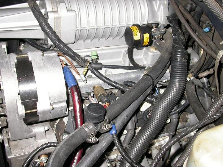

You would be much better off to avoid running fluid lines into the cab...especially fuel. Definitely stay away from mechanical if you are putting the gauges inside.
I am running electric fuel pressure and tranny temp gauges, and a mechanical boost gauge. My autometer fuel pressure sender threaded right into the pressure port thingy on the driver's side fuel rail, very easy install.
Doesn't sound too hard, and thanks for the pic!

sorry to resurrecct an old thread but I will be doing this soon. Just ordered my Radix and want to get a C2 fuel pressure guage.
Thunder550, looks like you just hooked into the radix fuel rail? Is there a fitting for this on the fuel rail or did you have to do some modifing drilling/tapping/ets. Basically I am trying to figure out if I need to buy any extra adapters or anything before I install.
