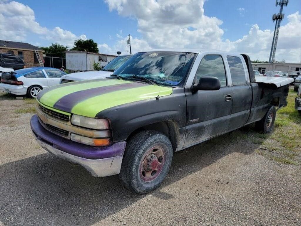

I did something I probably shouldn't have, and bought another pickup off an auction. I found a 2000 C2500 with the 6.0 and NV4500 that I wanted to swap into my 02 reg cab. I thought I got a great deal on it, and after having it shipped, this thing looks about as suspicious as the faded ticket and packages with different address and names in the bed (I'm thinking they were a porch pirate). I bought it cheap enough that even if the engine and trans needed rebuilt it would still be worth it.
I found three different temp tags over the last year, from three different dealerships (at least). The bed was replaced, and then rattle canned over most of the pickup to cover it. There are extra switches, cut wires, the small ground wire off the negative batt terminal is disconnected (first fix). I'm going to pull the engine and trans along with what I could use for the swap, and then sell the rest as a roller/ chassis (with a clear title). Unless I can find someone who wants it right away, I'll probably pull a few things and take pick n pull scrap prices for it to get it out right away. Its got a multicolored hood, no plates, and my HOA doesn't allow it. I really don't want it sitting in my driveway for long. I measured it, and if I pull both bumpers off, I think I will have 2" to fit it in my garage. If I can't get it running to pull it in there, I'm literally going to have to pay tow truck to move it 20 feet (up a 2 percent grade driveway).

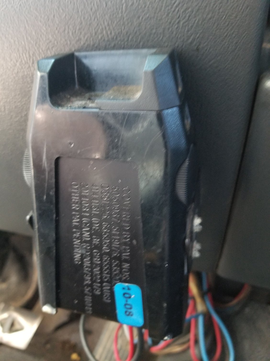

I should take a picture of what it is wired too, I'm sure someone knows.

Thicker wires and the top clip slides. I'm wondering if its some kind of DUI device.

and looking again at that picture again, yours might actually have the shorter lid because i think 2001 is when the revised HD look added the body lift to accommodate the duramax/allison combo
