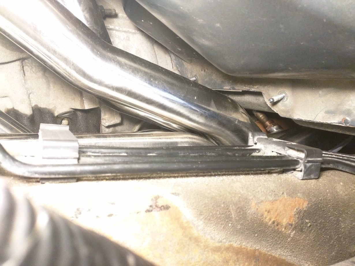

O2 Sensor hits here. Its double walled steel where I used a large drill bit to cut space for the sensor. I didn't cut enough.

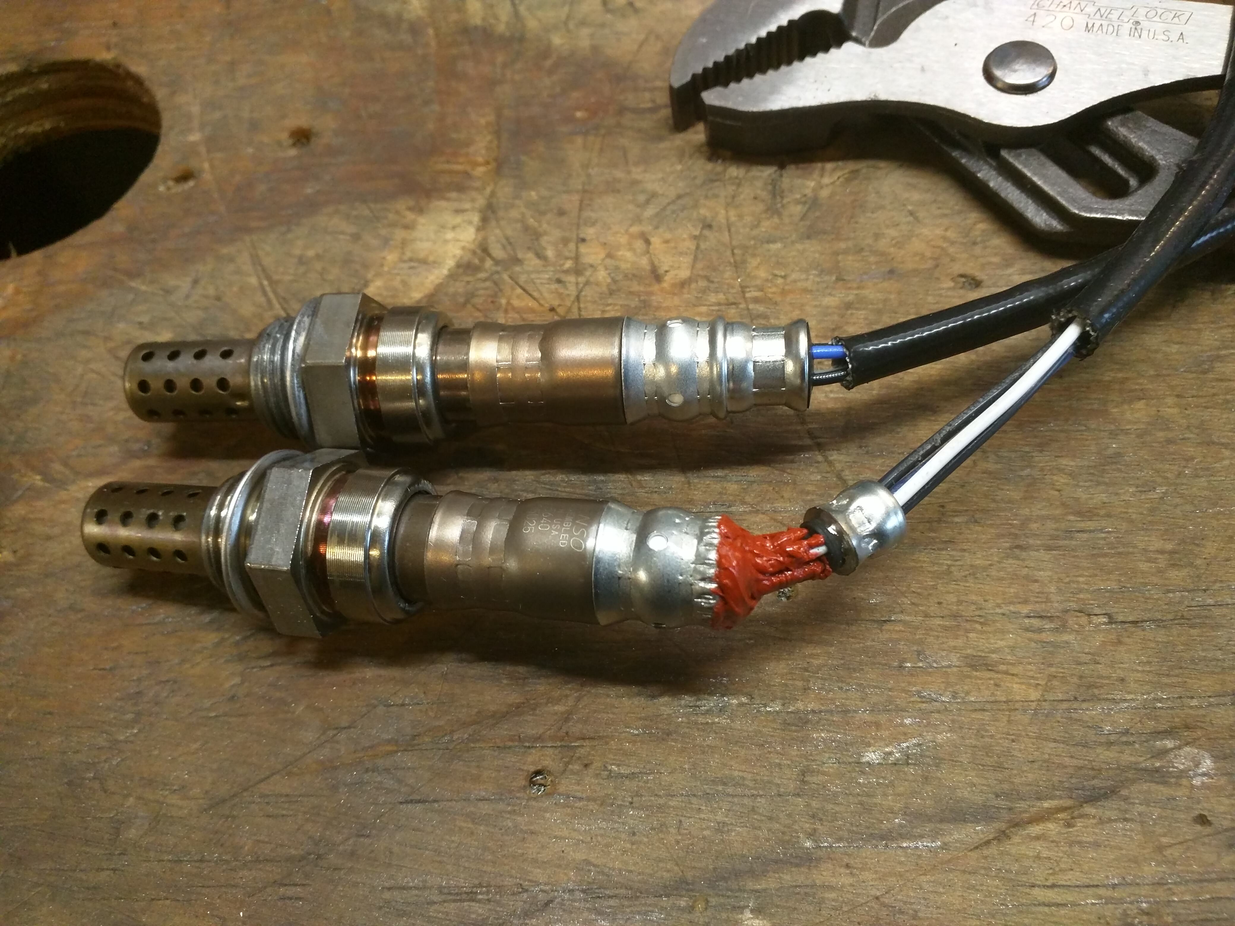

Trimmed O2 sensor. I can at least drive normally without hitting. I used a dremel.

Add a nice resonator back in, that should tone down the rasp a ton when using the stock muffler. That or a decent sized cat will act as a nice resonator in most cases.
I wouldn't cut a hole but more so just pound the body in with a hammer to make more clearance for the o2 sensor.
I was thinking about putting the stock resonator back on. I'll try that AND a cat.
I wonder if pounding things in would be enough? Cant hurt to try though I don't have a lift.
Think I could do it on my back?

- I trimmed the O2 sensor which helped a little. Stupid if it works?
That's what I did.

Dumb question. What kind of hammer? Like regular hand held. Sledgehammer? I've never hammered in body parts before.
