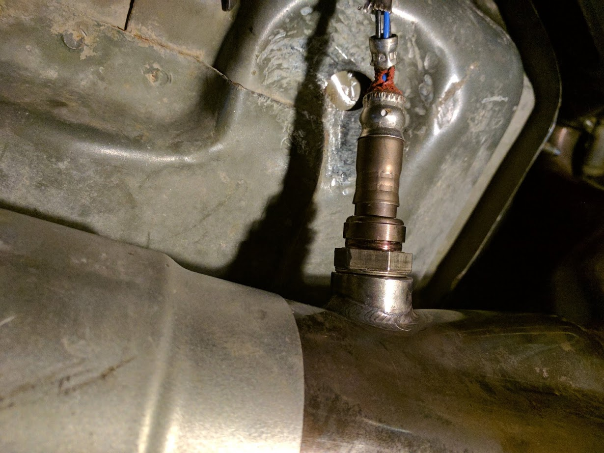

I pulled the heat shield in your last picture. No hitting.

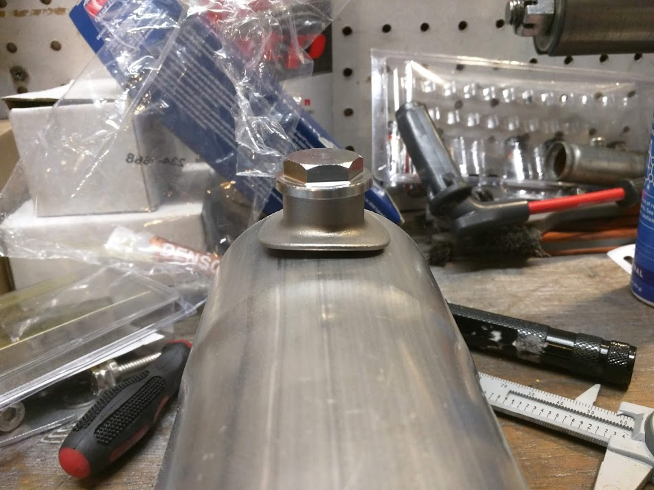

As far as the O2 sensor I plan to remove the drivers header and beat the **** out of the floor. There isn't enough room to do so properly with the header in. As pictured with the modded sensor it doesn't hit unless I FLOOR it in 1st. Otherwise no contact. Its still damned annoying when it does hit.
Agreed on it being nice to have info about plugs and primaries. I also agree there should be changes made to the part.
Worst case scenario I weld in a new bung and plug the stock one. I have the parts ready. I'd rather not subject my headers to my welding skills though.

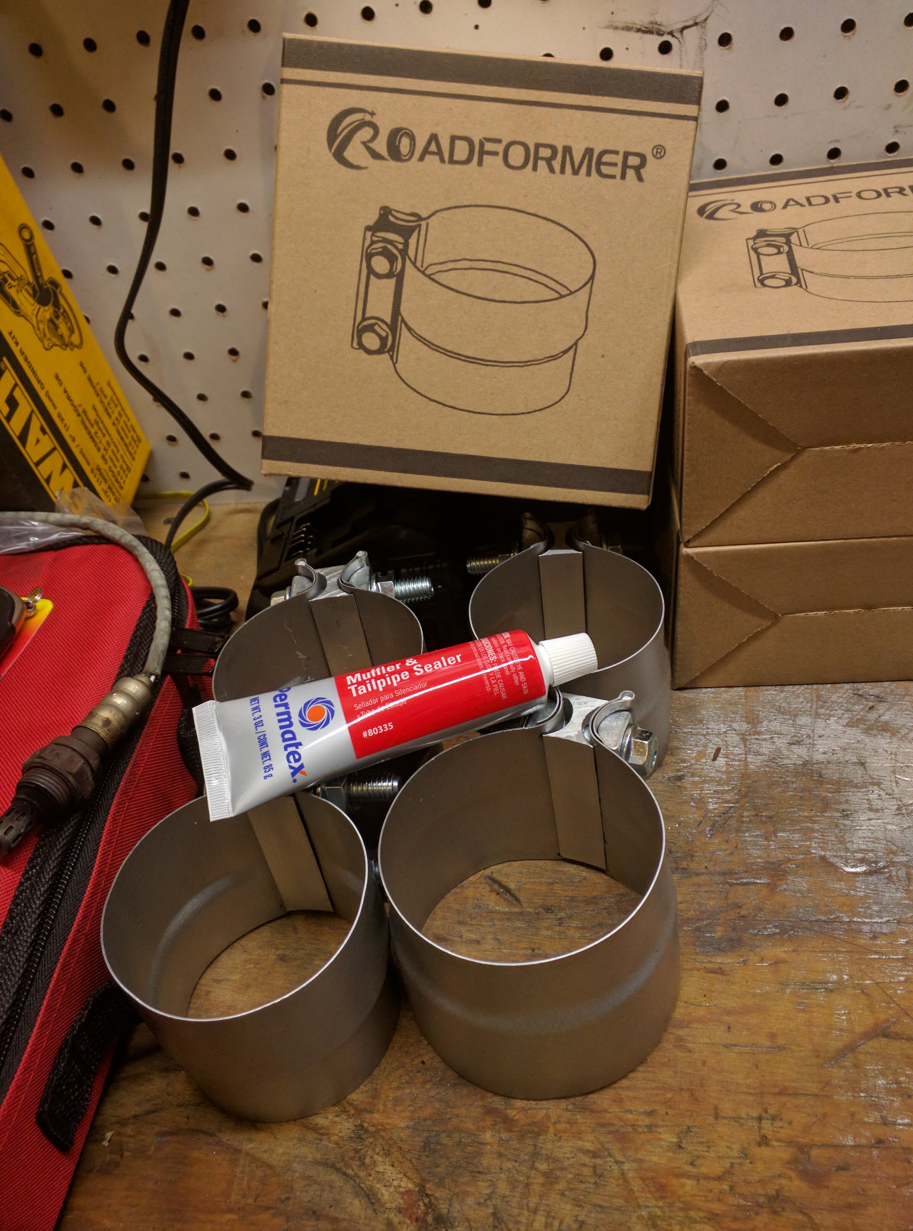

Did you expect not to remove the cross member? Thats pretty normal. I needed a mallet to tap the ypipe in place FWIW.
Get these clamps.
