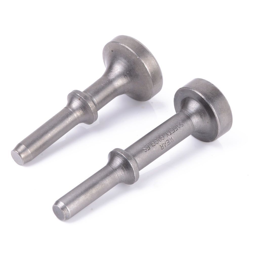

I've got an air hammer that I've never used. Would this work? Is there an attachment best suited? I like an excuse to use my air tools.
Like maybe a punch attachment?

I use these fat head ones because they have more surface area. They are my favorite for wheel bearings/getting rotors off and pushing crap outta the way lol.
Awesome! I'll pick up a set.
Those look fuuuuuuun......

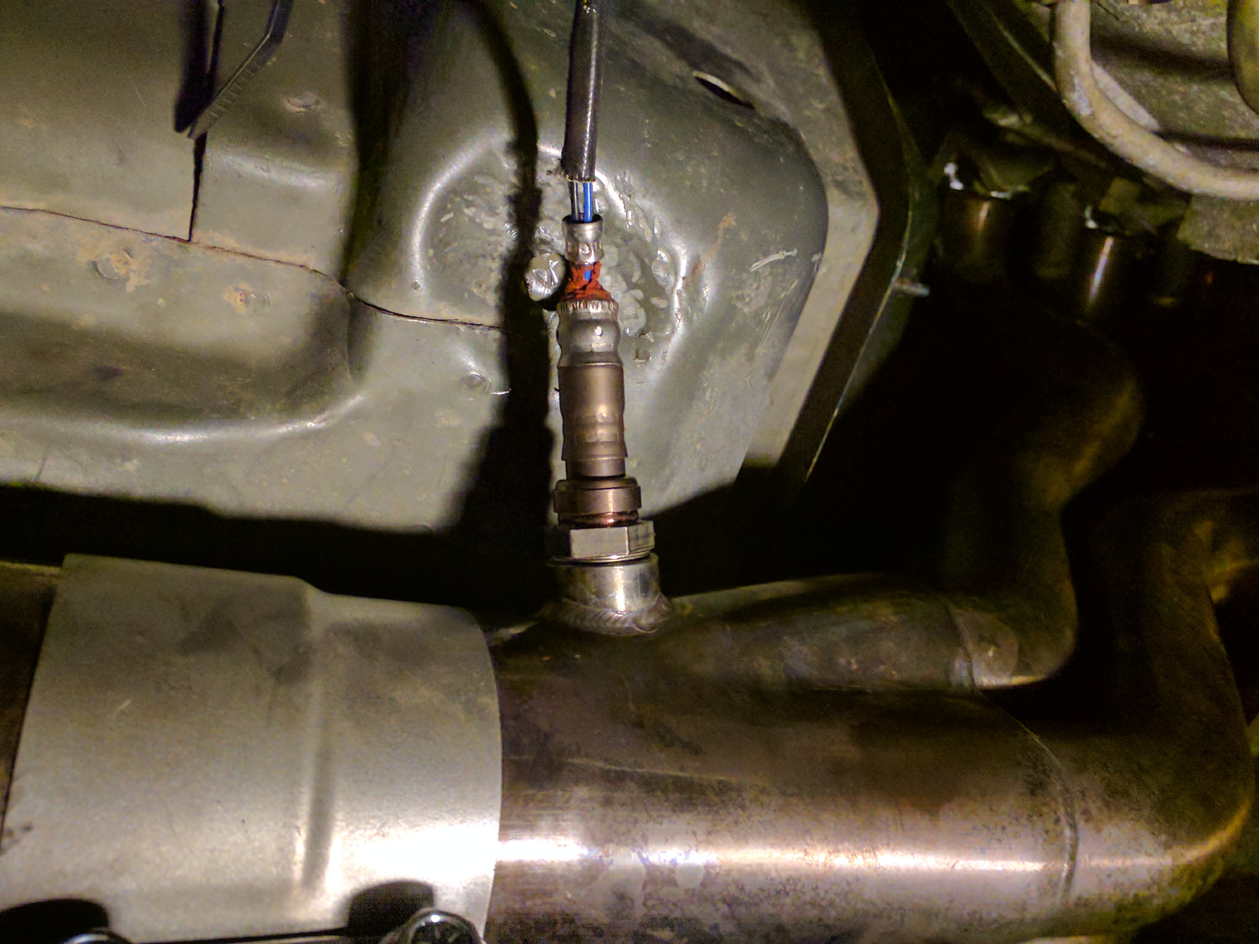

I ended up using a regular hammer. I need to dent in some more. It's much better now though. 1st gear launches will cause rubbing.
I also got a new bung and a bolt to plug. Perhaps I'll weld in a new O2 location. I suck at welding but hey, gotta keep practicing. I keep reminding myself, "$400".... ;-)

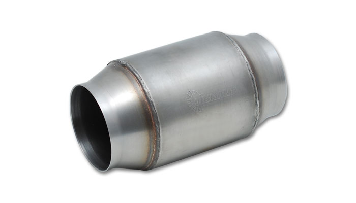

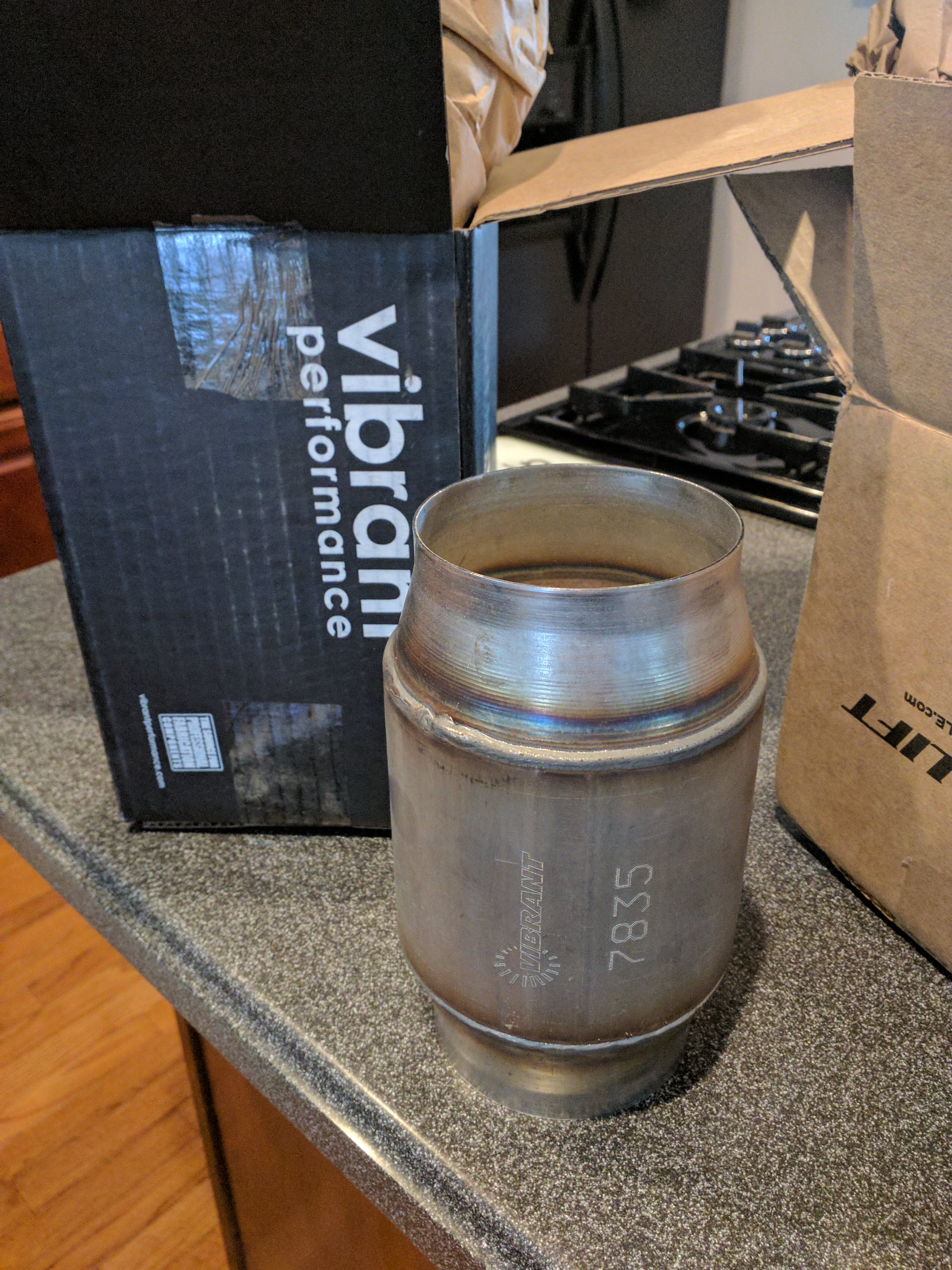

I have a vibrant 7835 3.5'' inlet short cat arriving. There is only so much room between the muffler and ypipe. I'd prefer to keep the stock muffler.
I hope its not too far out from the stock location and gets hot enough to tone down the smell.
I picked it up for $380 shipped so if it works almost as well as catted ypipe setups I'll be happy.
https://vibrantperformance.com/catal...oducts_id=2670
7.5'' long

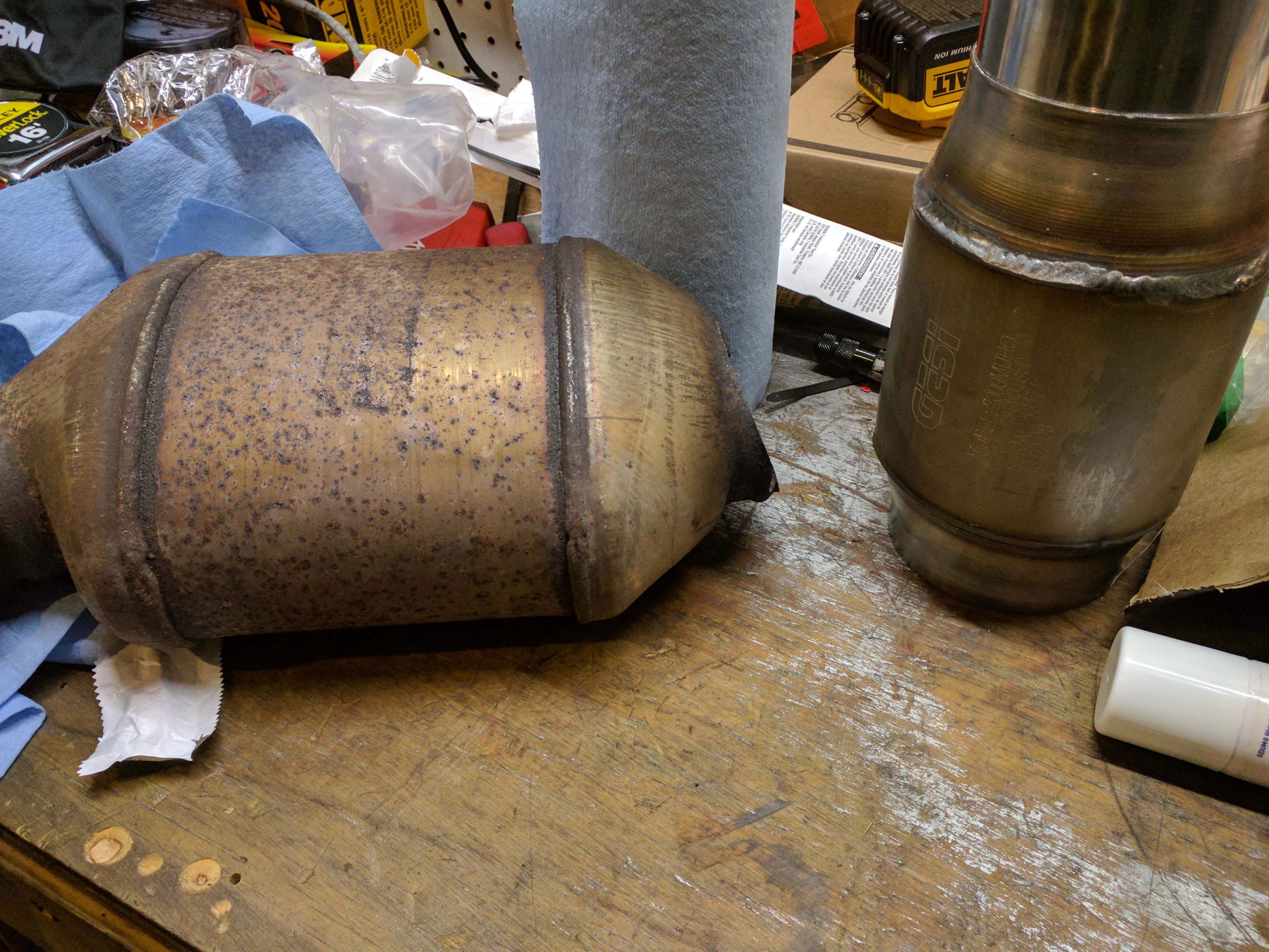

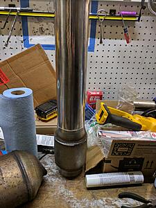

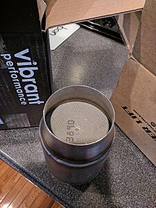

Got it. I have some spare tubing and will use the stock flange. I just need a flex pipe piece and 3.5'' ID-ID connector.
