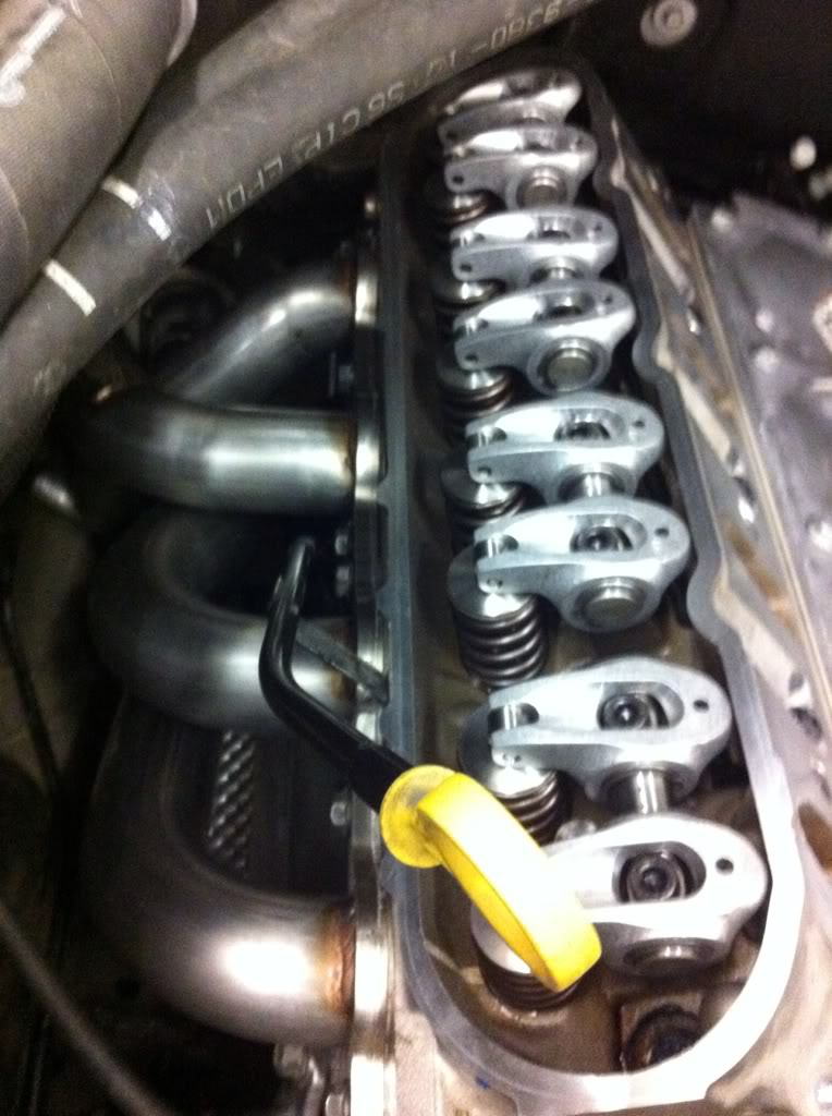

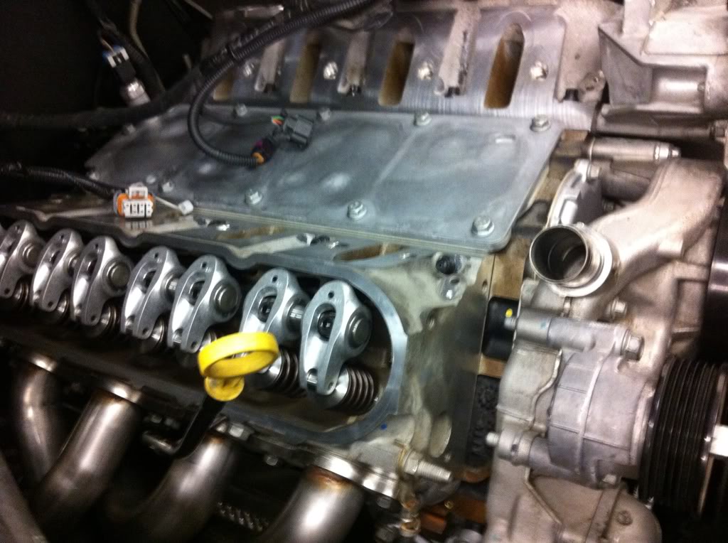

Hey Roger do you have any pictures of these installed?
