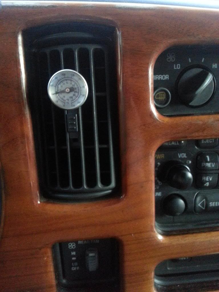

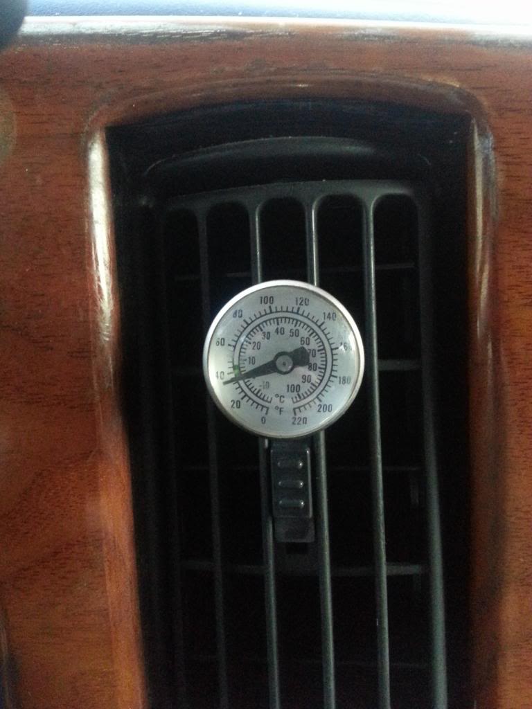

My Express idles at 750 rpm and I have a 25% underdrive on the crank. My CS-144 140a alternator has an overdrive pulley on it but is still only marginal for keeping the voltage up. I plan to switch to a Napa 200a AD-244 soon and upgrade the wiring. A/C was blowing 38-40*F yesterday and it was 95*F outside. The engine never gets over 178*F with a 170*F thermostat.

The E-Fans are not your problem, although the calibration certainly could be. You could be cycling on the high side cut-off. I would check for an overcharged a/c system.
How does it cool going down the road at 50-60+ MPH???? E-Fans should not even be running at that speed as the vehicle will have plenty of airflow through the radiator and condenser to not even need a fan. Also check to make sure the connectors of the fan match the motor correctly and you are pulling air rather than pushing air. If you are pushing air through the radiator and into the condenser that would explain the poor cooling.
