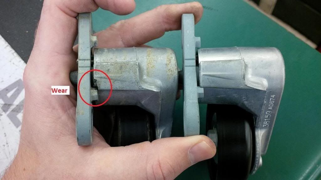

So I figured out that its the tensioner that is failing - not the belts. The tensioner failed the same way it did 1 year ago - a distinct wear pattern against the hard stop. See image below. After it wears to a certain point, the spring in the tensioner fails and the belt shreds.

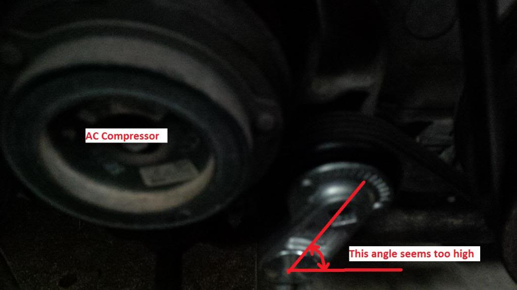

Here is a pic of the newly installed tensioner. As you can see, it seems the resting position of the tensioner is too close to the hard stop, which causes the wear as seen in the first picture.
So what could be causing this? I'm running an '04 5.3 block and balancer, with an '01 6.0 AC compressor and bracket. Could there be a mis-match that causes the compressor to not line up ideally? Could I space the compressor further down to increase tension on the tensioner?
Or maybe just get a shorter belt?

The tensioner was mounted incorrectly in my picture above, I'm a dumb ***. I fixed that and its fine now. It bounces around a little, but seems normal.
