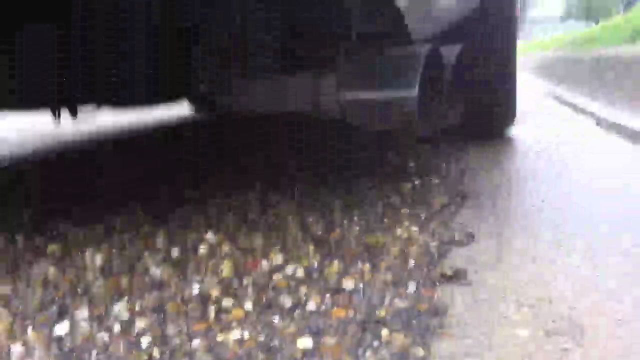

Here is an idle video of a 5.3 with a RKV3X cam
http://i10.photobucket.com/albums/a1...N/7bd8e2fa.mp4

your link doesnt work
