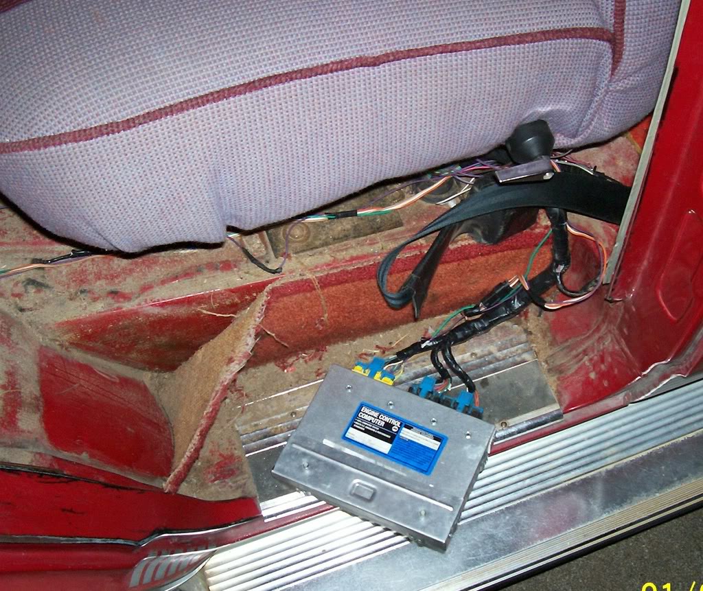

Its much easier and more reliable just to repin the connectors. The connectors are easily depinned with a tiny screw driver.
Dynamicefi.com if you want to stick with the older style ECM. No chip burning needed.

WRONG.....
The connectors are different but the pins that are attached to the wires are the same and easily unpinned. 85-96 TBI and 85-92 TPI all use the same ECM connector pins on the wire ends but different connectors. It takes me all of 10 minutes to repin the connectors.

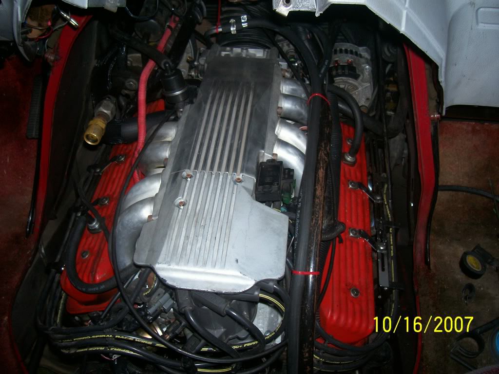

My 1983 G20 used the same 1990 G20 TBI harness for the early TBI ECM, then later PCM, then MAF TBI, then TPI, before being swapped to a 7730 TPI ECM.
Tje last engine in this was a 380 rwhp/425 rwtq 383 TPI and I had it totally gutted inside, down to 4,500 lbs.
