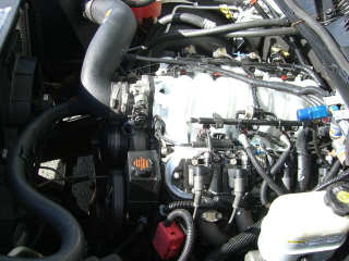

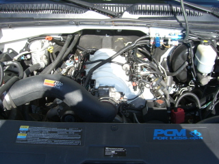

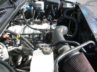

Old Jul 2, 2006 | 02:28 PM
Quik's Avatar
5 year bitches!
Joined: Oct 2003
Posts: 4,890
From: Pittsburgh!!!!!!!! Pa
direct bolt on but had to lenghten the ALT wire since its down lown now
not the best view of it tho
Attached Thumbnails Truck & LS6 intakes, differences Fuel system Q's-11.jpg   Truck & LS6 intakes, differences Fuel system Q's-13.jpg   Truck & LS6 intakes, differences Fuel system Q's-14.jpg
