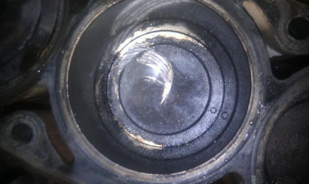

I got the 5.3 out and the valve was bent (duh) the piston was not as beat up as I thought and it did not touch the cylinder wall. . It did crack the valve guide. So new valve,valve guide, seal,spring and small parts and it would be good as new. I guys shouting it off as soon as it happen did work out for the best. so the 5.3 and heads will be on market before to much longer.

bigger pic

Looks like the valve cleaned some carbon off for you.
Yeah, that was about the worst of it. It was not as bad as I thought but a good reason to build something different.
