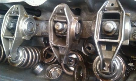

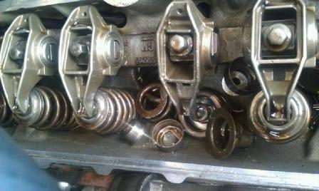

I was head home from work yesterday and heard a swoosh of air the something that sounded like marbles is my engine. I hit it in neutral and I hit the E-lane with-in 50 yards and shut her down. waited for a tow truck for 20 minutes. got home and found this.

Looks like the rocker arm let go.

I might have. There is needle bearings and chunks of springs everywhere.
Not "might", that's a darn guarantee. I can see a dead rocker arm in the picture LOL. Since the arm most likely died first, I can see the spring getting the crap beat out of it off center.
your probably correct, ether way it sounded pretty wild.
