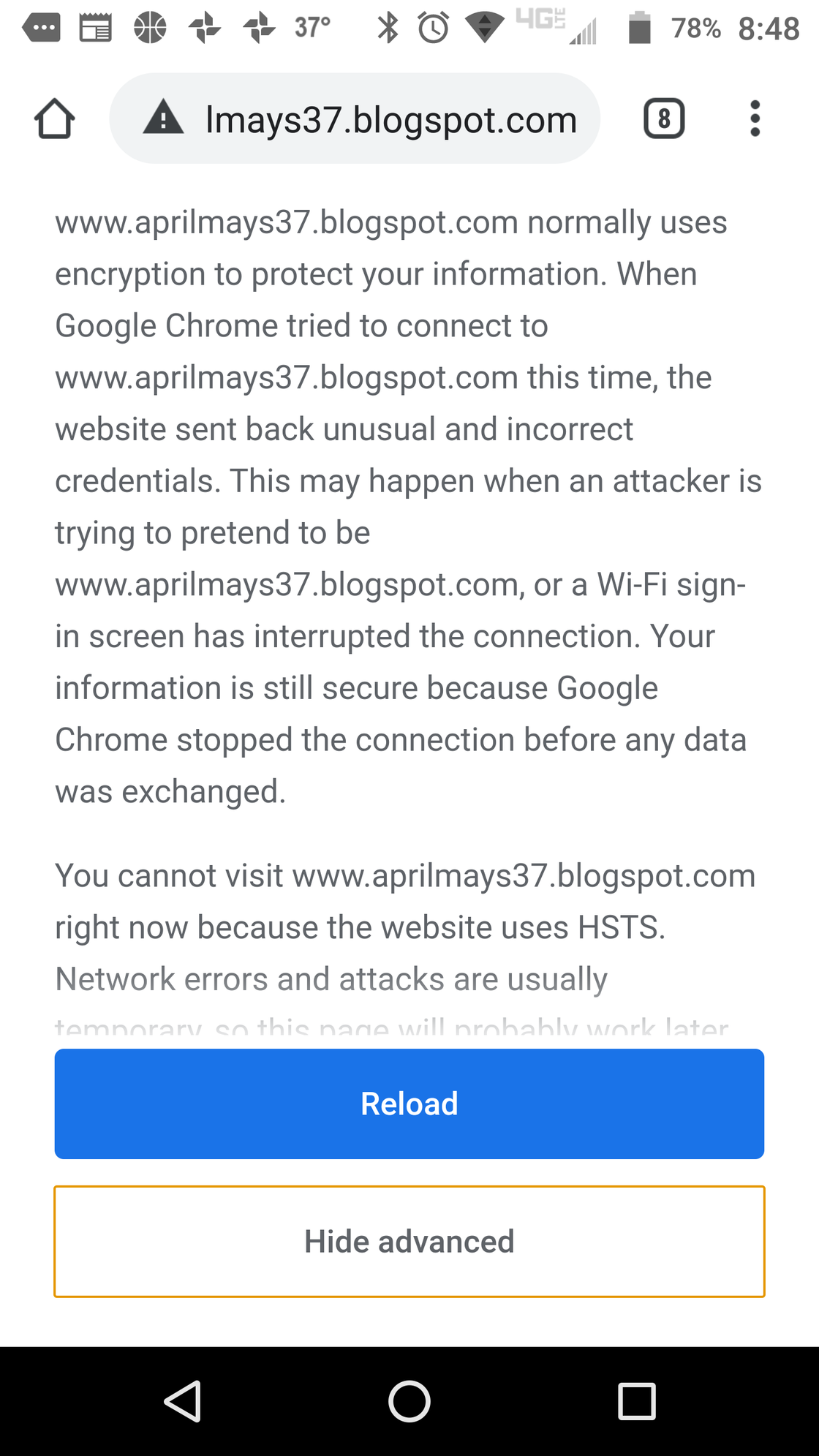

What is your location, and FYI look at the build link in your signature:
