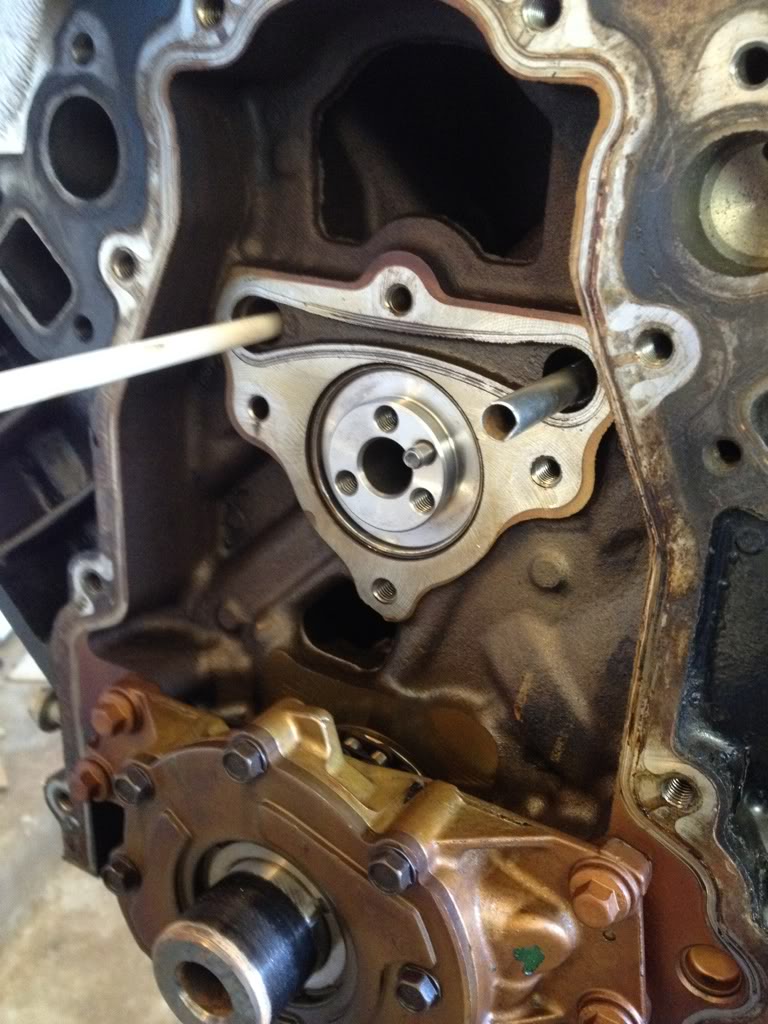

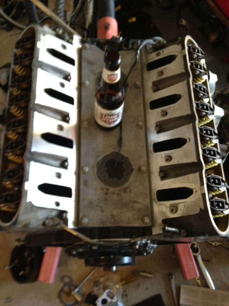

LS6 camshaft and valve springs installed

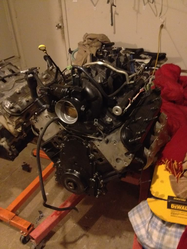

A little colormatching was in store, I think it turned out pretty well. The water pump is black too, just not on there yet.

You will like the lq9, i love mine but why dis you go with such a small cam?
Old Jan 29, 2012 | 11:15 PM
geareater's Avatar
Joined: Jul 2009
Posts: 87
From: Austin, Texas
I got the cam for free and also a lack of a built t/c. Once I save for an 80e I'll get a bigger cam, exhaust, and some real go fast goodies.
