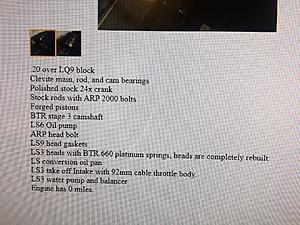

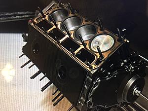

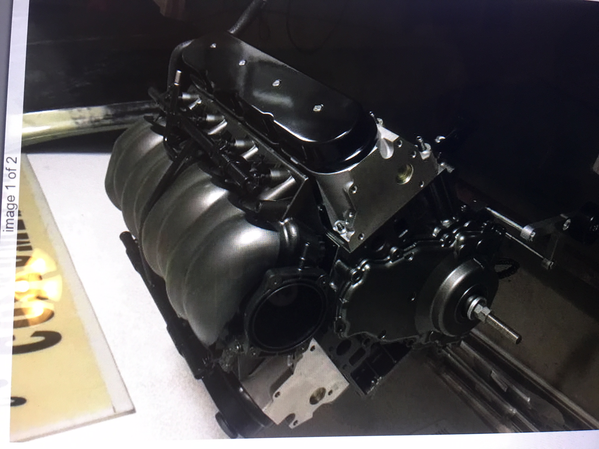

Ok just pick this up and before I put this in, I would likle to know if it would be worth it to add forged rods as its already together !! I do have a procharger and ring gap is for a NA motor and I run 10lbs of boost.. Thanks Rick.

Id run it as is. IMO. 10lbs is not a lot

def not worth it for 10lbs of boost...run it as is
