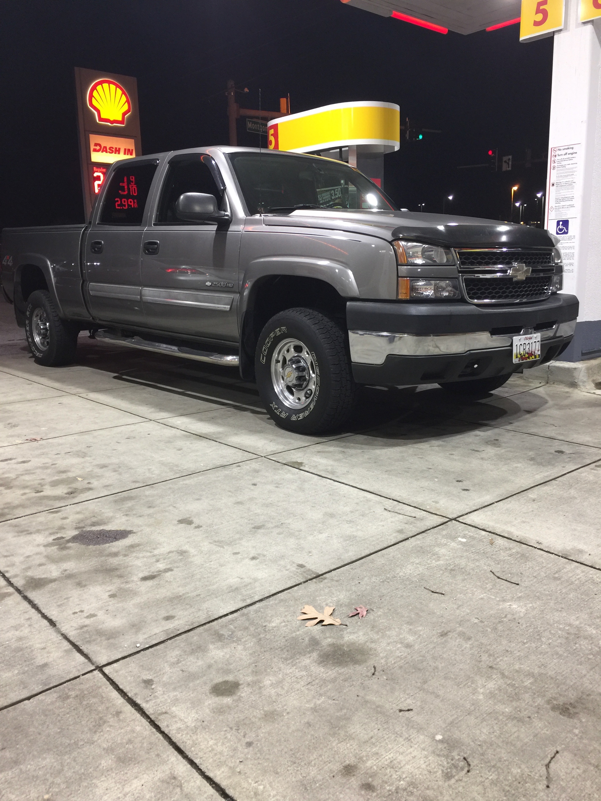

New to the forum. I own a 2006 2500HD 6.0/4l80e. Goal is to have a daily driven 650-700hp truck that can drive in weather, haul my boat, take vacation with cold A/C and still make some good power. Would love to touch 11s and cut some decent 60s. Talked to a few shops on turbo kits and KB and Trick are for sure where I'm headed. KB 100% has my vote so far due to great communication. So just wanted a general thread on to do's and not to do's. So far this is what I have come up with:

You probably have one of the most turbo-ready platforms out there, and it sounds like you're looking at the right vendors. I do like Trick's cast manifold. You've got just about all the bases covered that I can think of.
I didn't see it mentioned, but based on the photo it appears to be a 4wd. This is actually a good thing because it means your driveshaft is shorter (higher critical speed).
