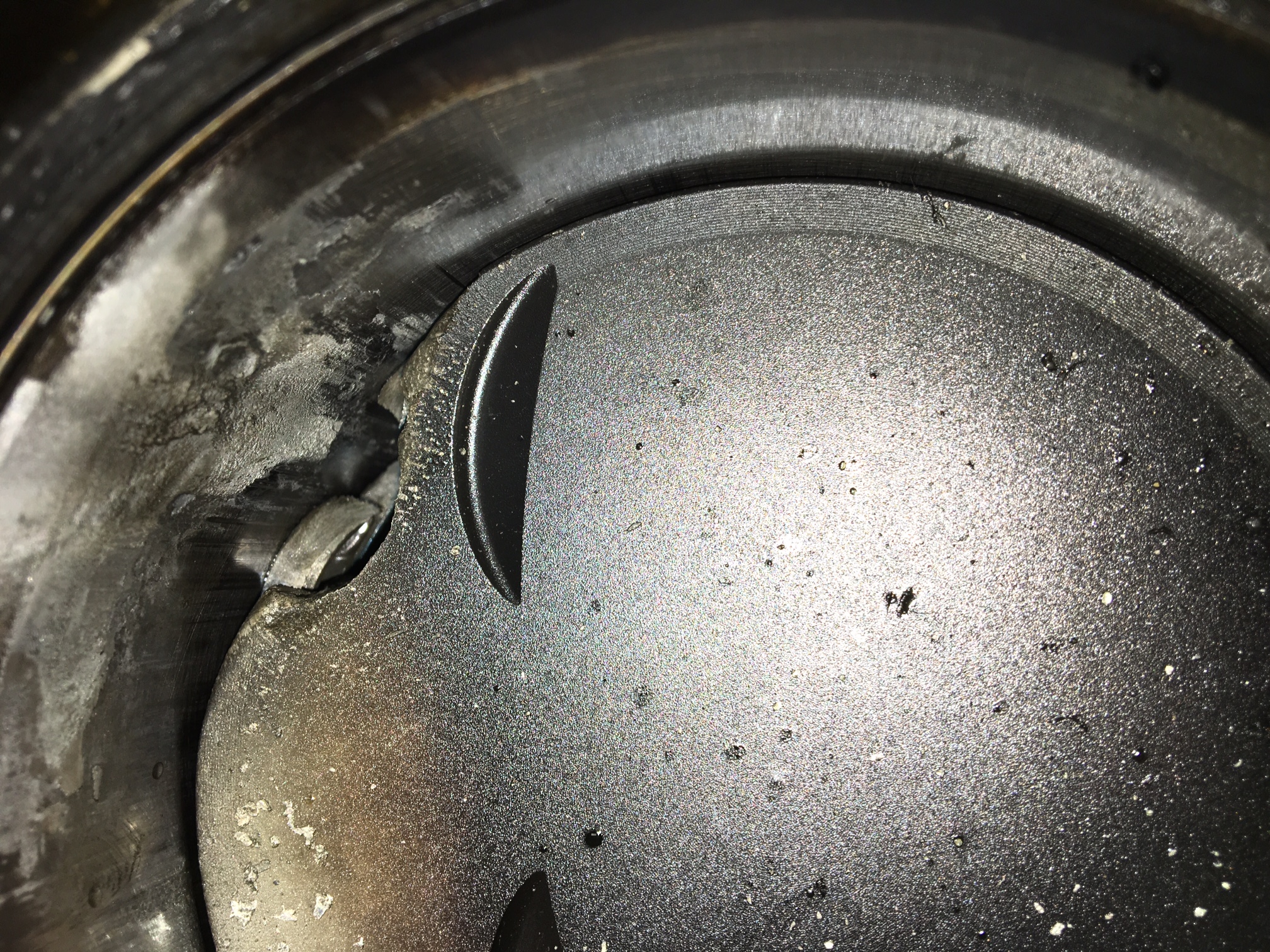

So...5yrs ago I blew up my Avv and just getting around to fixing it. Seems I tore the #1 piston apart - melted the plug, leaned out most likely - on an uphill WOT run. Meth pump gave out...etc. Im going to get it running, but prefer not to go nuts on $.
Anyway, have new block and trying to decide best route. Ill prob reuse my MP122HH and most of the hardened internals (eagle crank & rods), but might like to go bigger cubes and more torq? 408 stroker? Im looking for ideas and suggestions and try and reuse as much of the parts as I can. Here's what was in it - made 555rwhp/550 torq:

The damage to #1

As much as you can get away with based on your fuel is the answer...
10:1 is a pretty common pump 93 blower SCR. You could get away with more on e85, meth injection, or race gas.
Yep, that's detonation no doubt. You might want to consider 9.5 or so then. Also make sure you are using the right heat spark plugs.
