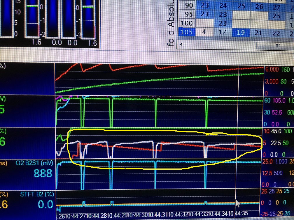

yes at first I thought my mind was playing tricks on me. Cruising felt it little slower but I didn't think much of it till the other day I smashed the gas going 60pmh and nothing like no increase in acceleration rpm didn't go up much and it didn't down **** like it should because it just wasn't accelerating enough. I think is what someone said avobe that if the knock sensor code is on it pulls timing out of and it makes sense.. oh and my truck is not loud like most with no tail pipes
KR could be the culprit do you have access to HP Tuners or willing to pay a shop for a tune/retune? I had to lower the knock sensors sensitivity on my truck to get rid of false knock. I lowered the timing and boosted the octane and the KR didn't change. False knock shows up as a little random spike in the VCM Scanner. Real knock looks like a stair step across the scanner usually under sudden throttle or a heavy load. Buying HP Tuners was one of the best things I've done for my build. I'm not a tuner but I've learned enough to keep my junk running strong
You can see the stair step red line... this is real knock which can do damage.
Oh thats very cool. I was thinking of getting an hp tunners when I get to putting a cam, heads intake. Injectors and fuel pump. .. how much was the hp tunners?
