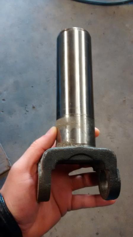

Quick question... will my driveshaft work? Or does it need to be shortened?
Old Sep 6, 2014 | 03:46 PM
LS1TRUCKGUY's Avatar
Joined: Nov 2005
Posts: 2,452
From: Deer Park Texas
driveshaft will work with a th400 slip yoke and a bastard u joint. i have the part # for the u joint at home. i saw somewhere on here that someone found a slip yoke that uses the stock u joint, but i have no idea of the part number for it.

A friend of mine gave me a yoke, I'll have to post a picture. He had an LQ4/4L80E swap in a 96' Tahoe and used the yoke he gave me with the stock DS.

just finished up basically the same project in my 2004 RCLB, my stock one piece driveshaft ended up being the right length, just a crossover u-joint, the bigger yoke and that was all i needed..

Thanks for the reply, been meaning to post. Finally got around to snapping a picture of the yoke I have.

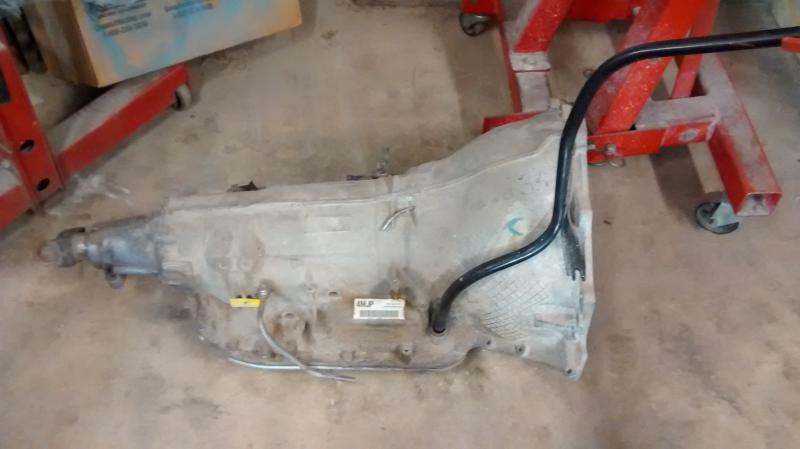

And my transmission...
I still need to find a u joint for it ASAP, I'll be starting the tear down on the 6th.

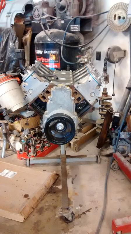

Long block is all buttoned up, tear down starts tomorrow afternoon.
