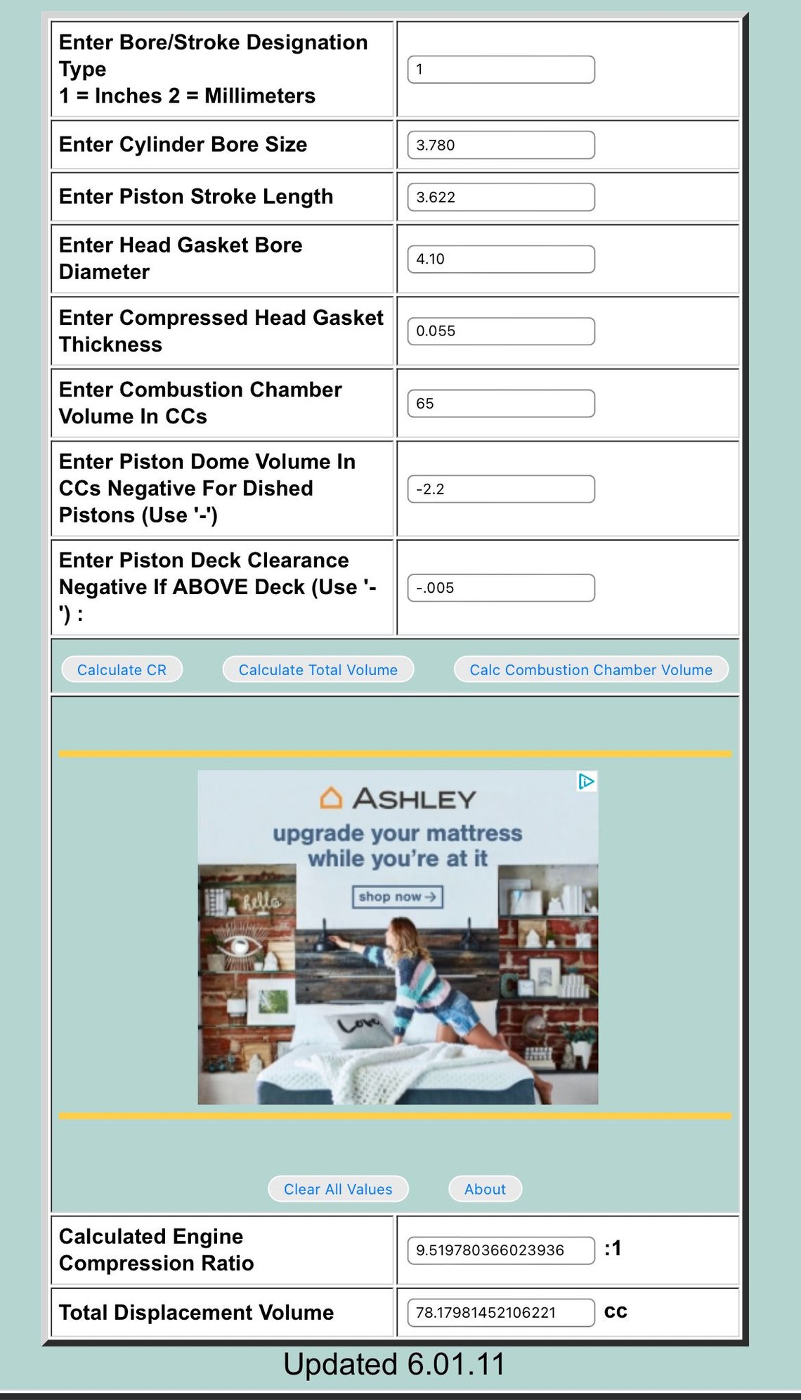

If I run 243’s with the BTR ls9 head gasket it gets me here.

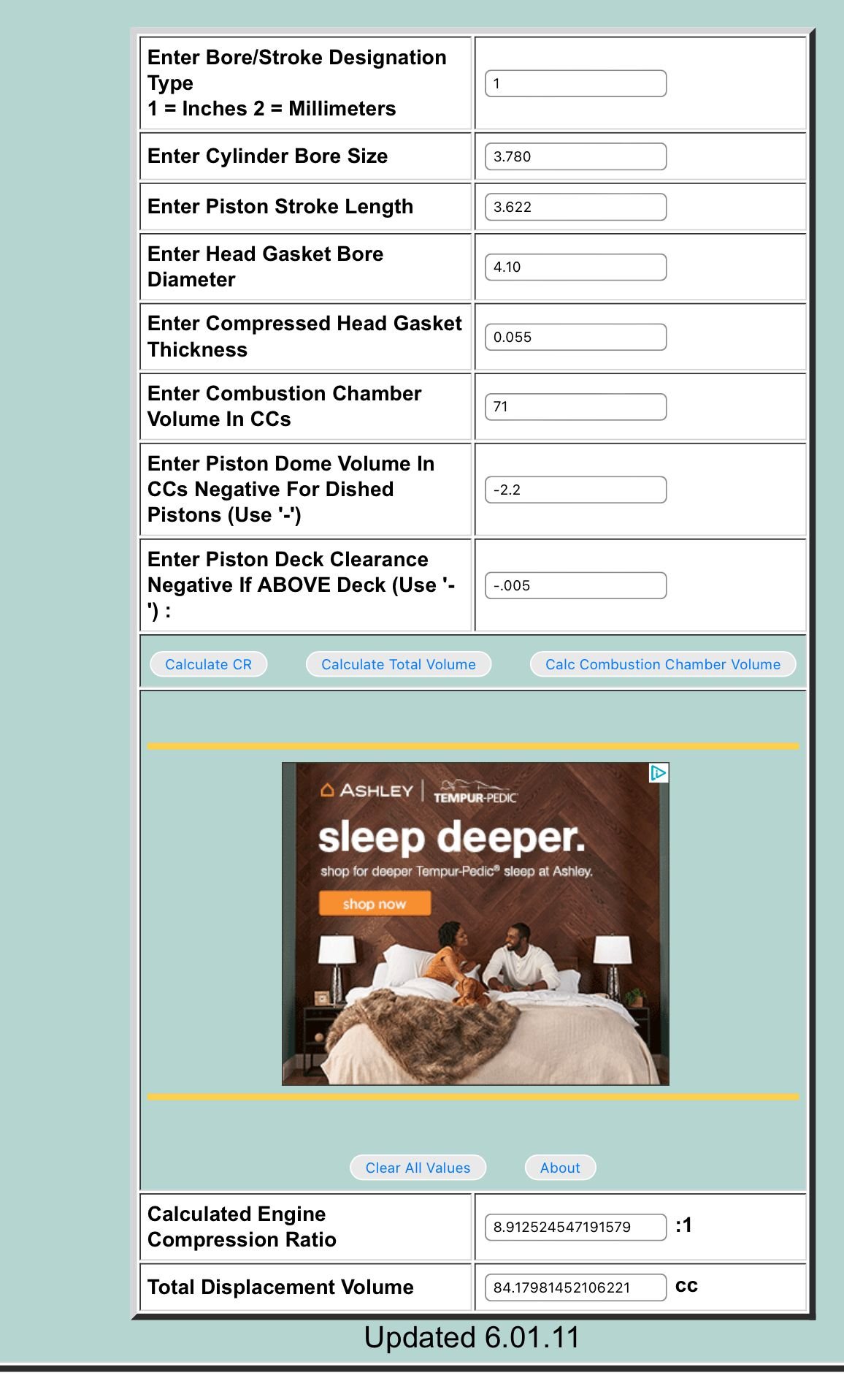

317’s with ls9 gaskets
