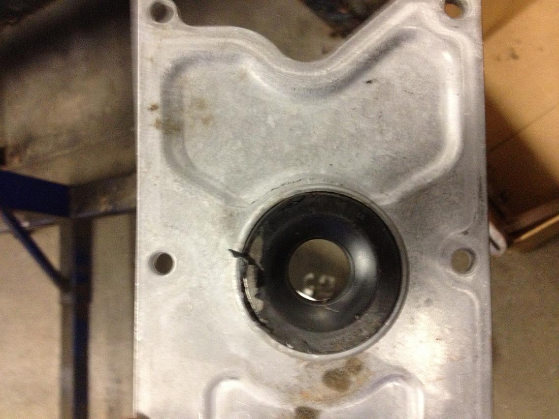

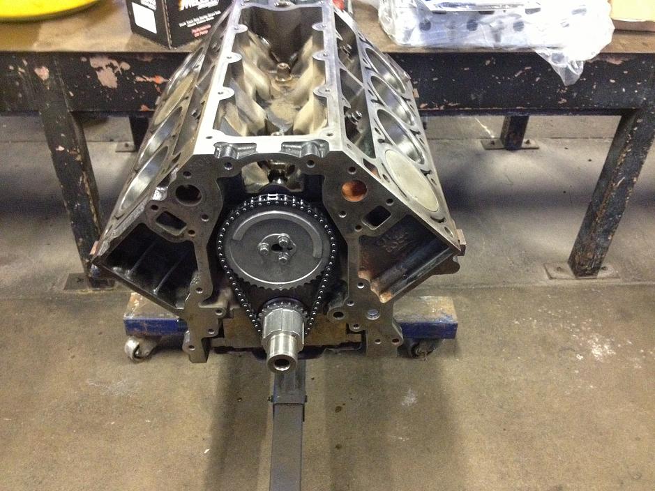

got a couple of ? on my build started to install oil pump and wondering is it worth installing the stiffer spring that comes with the HV oil pump or no? next is I need to know what goes in the hole on top of the block next to the cam position sensor? it doesnt look like a sensor more like a sight flow indicator of some sort. next is in the how to build ls engine manual it says to use an old head gasket and old head bolt to bolt down the head to measure PR length, well I dont have any of the old bolts nor gasket so all my parts are new will I be able to torque the heads down them measure for PR length? and last but not least anyone have a part number for the gasket in the valley cover where the knock sensors go? thanks in advance

I can't help you on the spring Question, but I have a thread with part numbers for gaskets and such. It's located in the stickies. https://www.performancetrucks.net/fo...umbers-428941/
Check with a dealer to make sure it's what you need. Sometimes Gm updates or changes the part number.
The one hole that goes straight down into the block is for the oil pressure switch.

You can put the head's with new gasket on and measure. No need to remove the head.
I think there was a thread describing how to do it.
