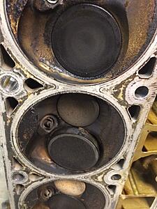

Head is pulled off, valve seat dropped and it hit the piston but not very bad. Got lucky. Very strange though. Never heard of a valve seat droppinh. Will post a pic when I get time

If it shattered the valve seat you need to replace the intake manifold and the Y-pipe assembly unless you want further trouble down the road. It sent pieces through both ways that can migrate back into the engine under varying conditions and cause a recurring failure.

Odd failure but at 200K miles almost no one can say it didn't go the distance.
