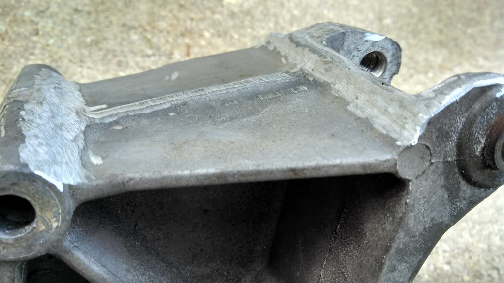

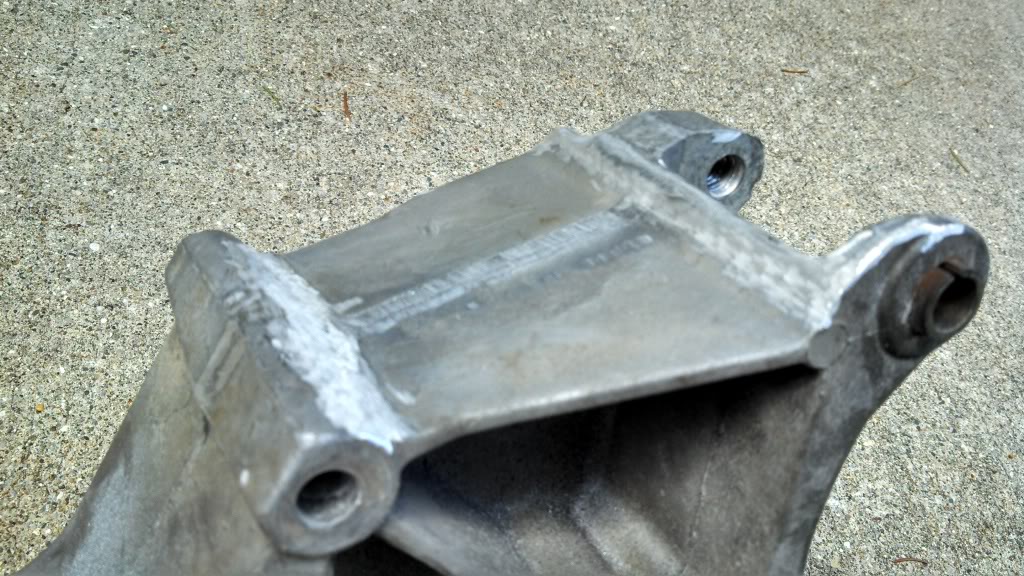

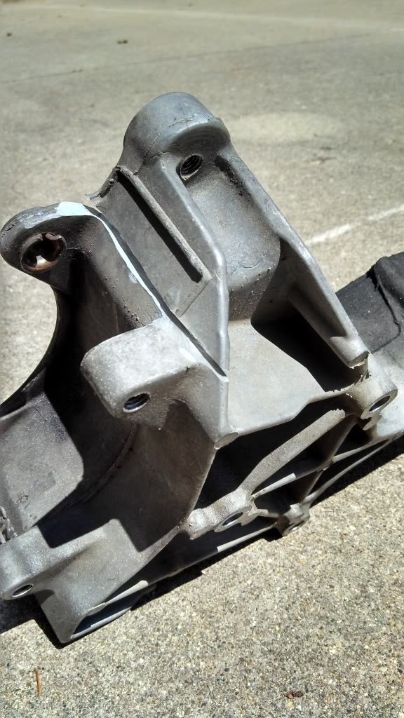

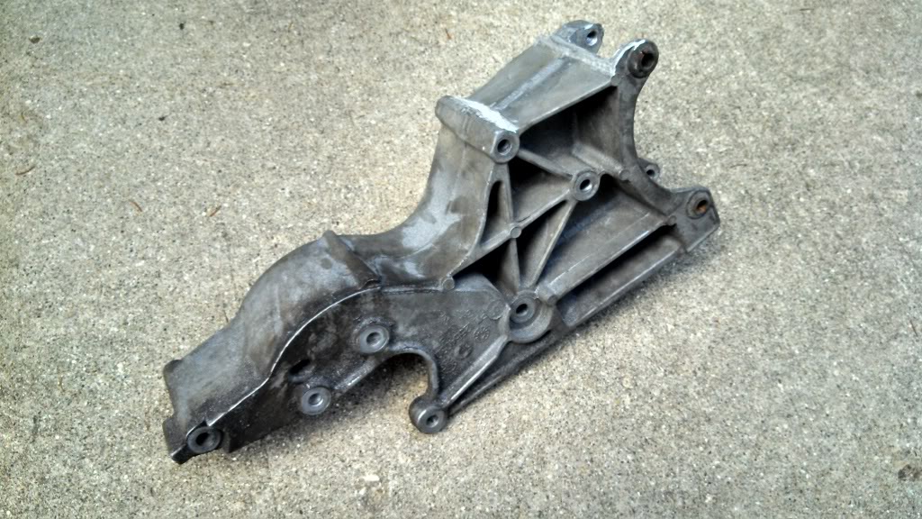

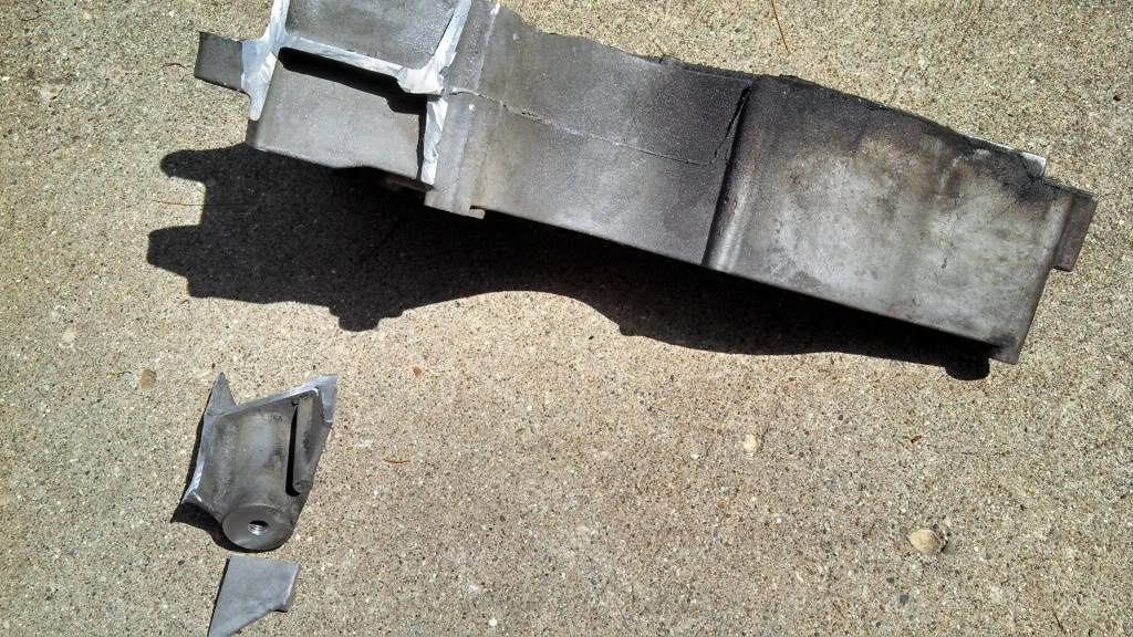

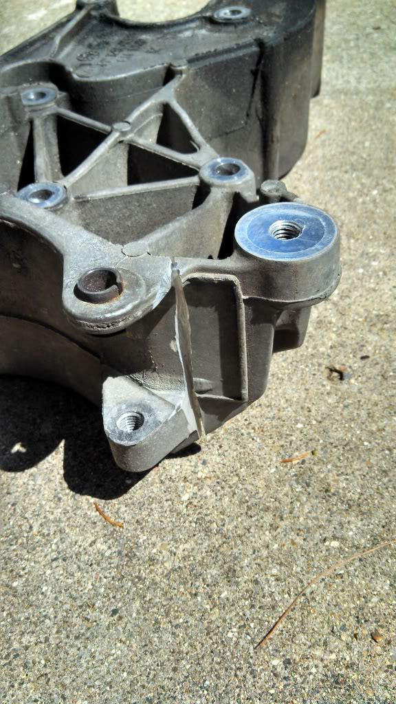

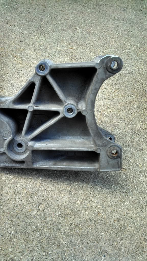

Alright, finally began some work on prepping things for the intake swap and a few other things...

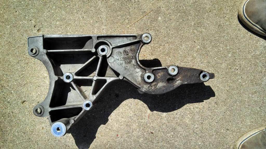

Removed Alternator/PS pump bracket and cut off the little idler pulley ear that needs to be removed for TB clearance:
started off looking like this:

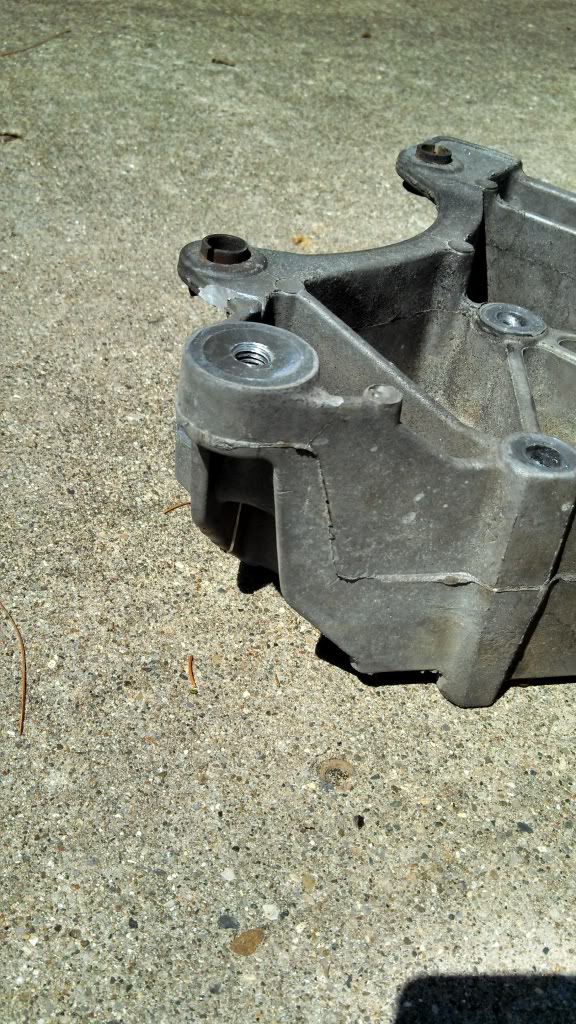

began cutting:

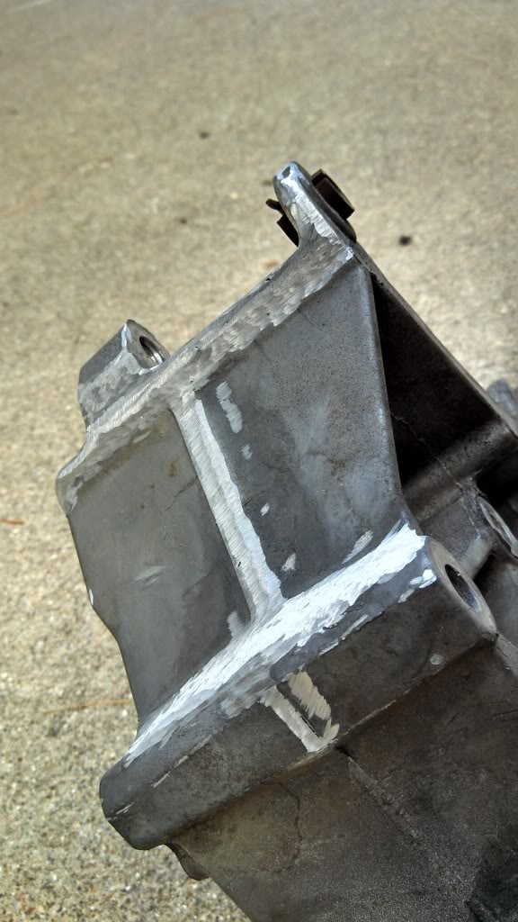

lopped off the first big chunk:

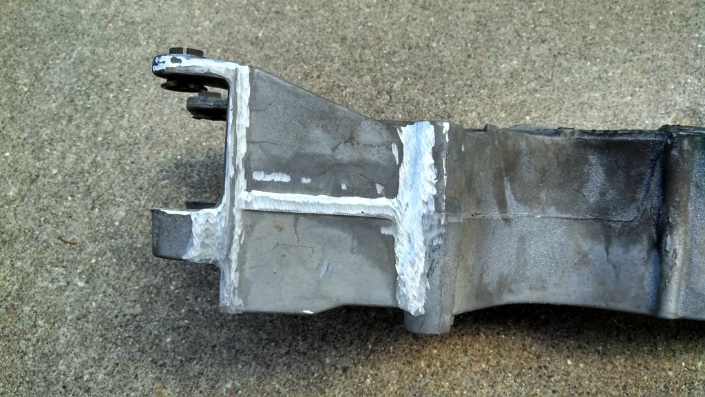

started smoothing it out to try to make it look unaltered after paint:
Gonna clean it up and paint it black tonight.

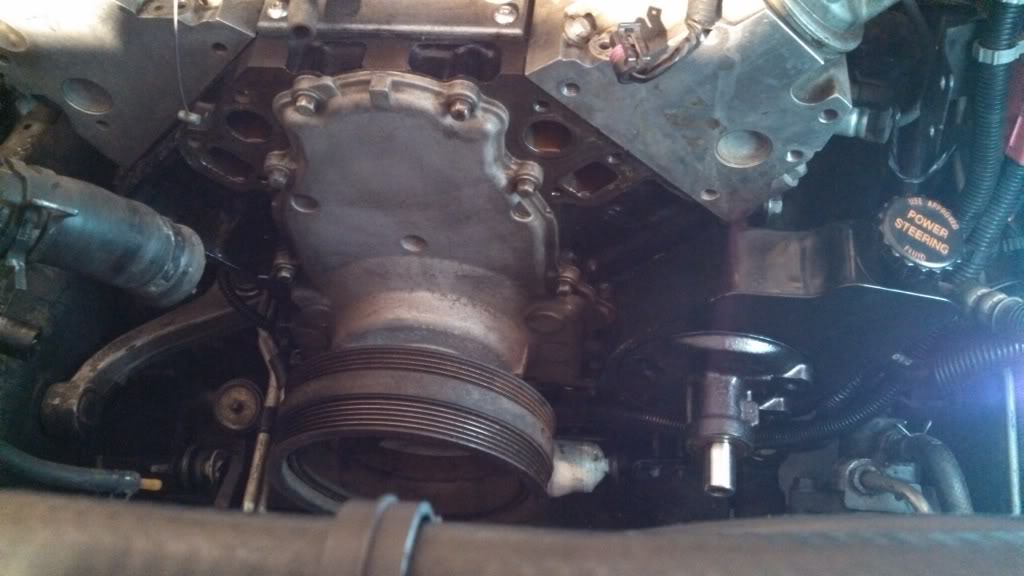

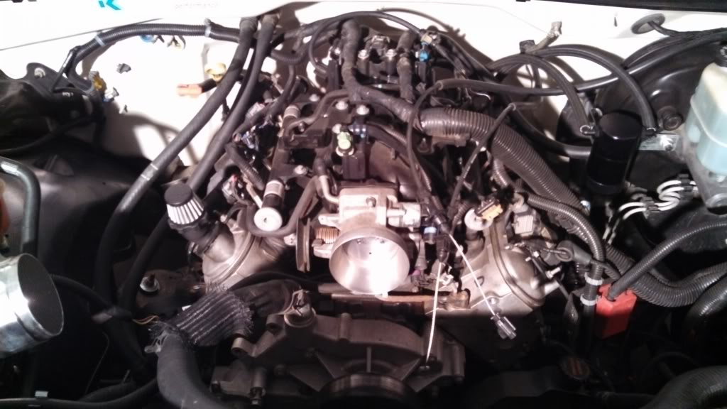

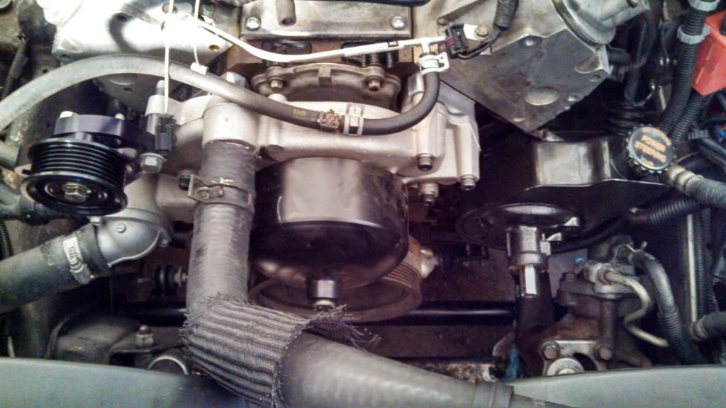

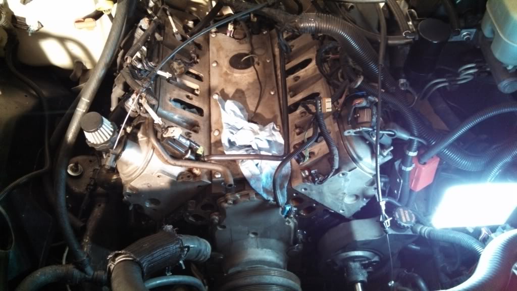

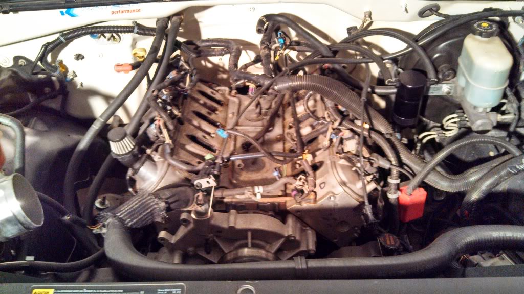

Engine began looking like this (after air intake removal and alternator/PS pump bracket removal):
Then popped the OE truck intake off:
Removed OE truck style water pump.
Also had to remove the coolant steam lines that were on there that connected all 4 corners of the heads since it won't fit under the LSXR. And swapped OE hex head valley cover bolts with button head allen bolts.:
Also replaced my leaking power steering pump:
Here's what she looks like now with the new take off GTO water pump + Dirty Dingo water pump spacer kit and Katech F-body solid belt tensioner.
Had to cut off ~5" from my upper radiator hose so it would reach down to the lower neck. Looks better than I expected it too actually, just glad it didn't kink and send me on a search for some obscure hose to fit.
REALLY do NOT know what I'll do with my wiring harness. No way I'm going through the whole thing and lengthening each wire.
Also kind of disappointed about having to run my EVAP thing to the front of the LSXR. Might look a little goofy...
Still have to drill holes in the shells for the MAP and EVAP.
