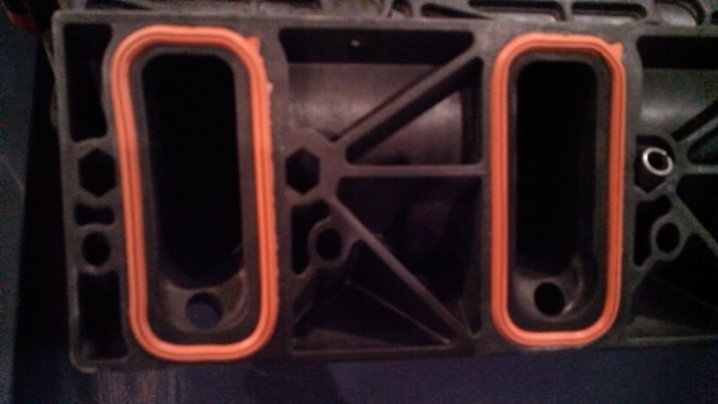

Pretty sure its cathedral.
But anyway, was really hoping on some more insightful tips on the car intake swap with truck accessories. And/or ls1 Meziere ewp mounting... Anyone know if the Dingo spacers for regular body water pump will work with the ewp?
Oh and what's up with fuel rails? Will the OE style rail kit that FAST offers work with my return style system?
Anyone?
