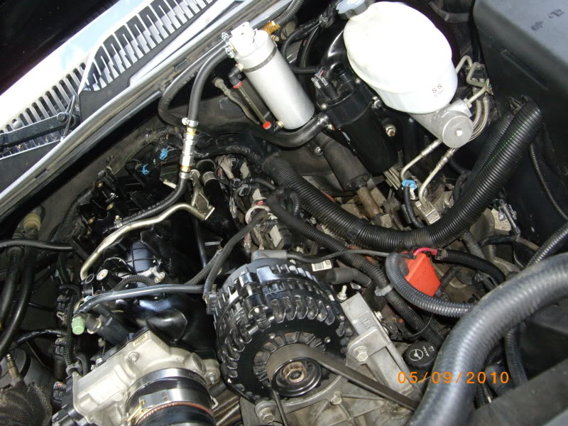

You can take that plastic bracket that bolts to the top of the intake out of your harness and then just kinda move the harness to go around the back of the engine. Just make sure your sensors are unplugged and then move the harness around the engine and then plug all your sensors back in. I ended up relooming some stuff to make it cleaner but didnt extend any wires.
This is the stock harness without any modifications. I think I still had even the black bracket in this pic

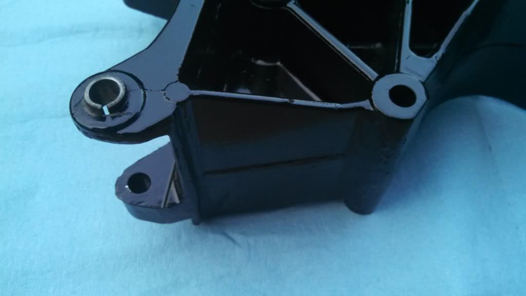

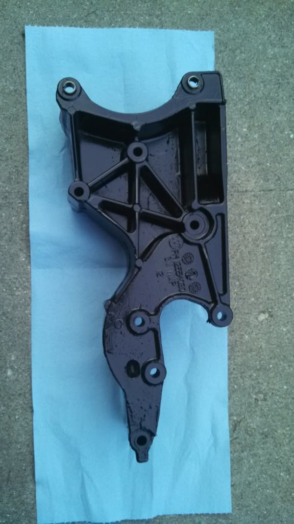

More progress!
Got the Alternator/PS pump bracket all painted up after grindage.
Actually looks better than I was expecting, so I'm stoked. Just wanted an unaltered look so nobody's eye is drawn to it and they see it was hacked.
