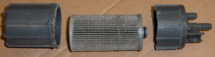

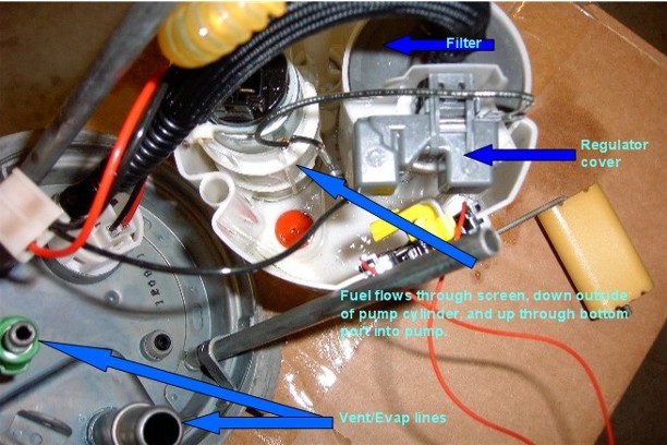

In the 2004+ returnless systems it has been incorporated into the fuel module which is inside the tank. There is some variation in designs but here is a pic of mine. It is not serviceable as a separate part and is considered a "lifetime" filter.

Dr.X is right on....in the tank, non-serviceable
