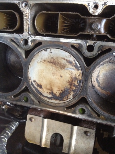

Looks like I'm a lucky SOB.
No other damage that I could find, all cylinder walls on that bank were perfect. head had no damage, even the exhaust valve that hit the piston looked normal, aside from the fact that it looked perfectly clean whereas all the other exhaust valves were brown. I guess that continues stream of ethanol it got cleaned it up??
It's pretty amazing to me that just this valve not operating caused the engine to run like such ****. But I can't find anything else wrong. Motor had normal oil pressure.
KB recommended just filing the defect smooth and running it, sounds good to me. I bet my dremel sanding bit will make quick work of it, with great care of course.
The other question is now what to do with the setup. Since I've basically got the thing torn down, lifters and everything out, I guess I'll do the cam swap I've been wanting to do. As far as heads, I haven't decided yet it I want to reuse mine or go with something else.

Long as the valve seats are good I'd just keep those heads. Too many people making 4 digits on stock heads to justify otherwise lol.

I had a couple.pistons have the same valve contact mark, I used some of the small 1 1/2" roloc discs on my drill and smoothed em.out, never had an issue with em afterwards
