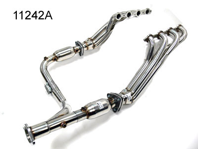

Default Has any one seen these?
Brand new stainless steel header system for the 07-up Chevy Truck / SUV application with 4.8l, 5.3l, and 6.0l engine only (will not fit 6.2l engine).
I have an 01 gmc 1500 5.3 and if this will fit my truck to not have the odd ball pipe on the driver side. I would spend the exert money up front and not have to buy the band clamp and things. Remind me of headman headers, I use to have on anther truck. They are on E-bay too for $495. shipped
Attached Thumbnails Ebay/OBX style header install w/plenty of PICS (LONG, but detailed)-h11424b-1.jpg

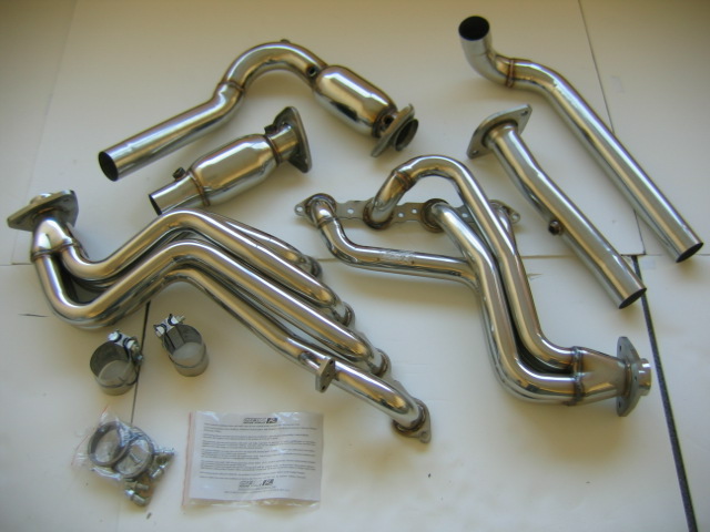

Default for the guy asking about one to fit the 6.0L
OBX Headers 99-05 Chevy 2500 Silverado Suburban 6.0L V8
HEADERS AND CATTED SYSTEM! INCLUDES HIGH FLOW CATS!
Please wait
Item condition: New
Compatibility: This information is not available.
Time left: 20d 20h (Sep 29, 201010:27:46 PDT)
Quantity:
Error icon
2 available
Please enter a quantity of $quantity$ or less
Please enter a quantity of 1
Purchases are limited to $quantity$ per buyer
Please enter a lower number
Please enter quantity of 1 or more
Price: US $695.00 Buy It NowBuy It Now
Attached Thumbnails Ebay/OBX style header install w/plenty of PICS (LONG, but detailed)-h10796s_3.jpg
hmmm, big decision for someone on a budget.
$16 for 2 band clamps, or $205 more so you don't have a "hump"?
It sure is interesting that you joined the forum 2 days ago and your first 3 posts are you "helping" people find headers on Ebay?????????? You're either a VERY nice person, or an Ebay seller who happens to sell headers but doesn't want to be a paid sponsor.

Camaro Zach's Avatar
Joined: Dec 2004
Posts: 373
From: Alvin/Friendswood Texas
One difference I have seen between the ebay and the actual OBX headers is that the OBX headers are all stainless. While the flanges on the ebay headers are cheap chrome plated mild steel. But still pretty good for the price.
