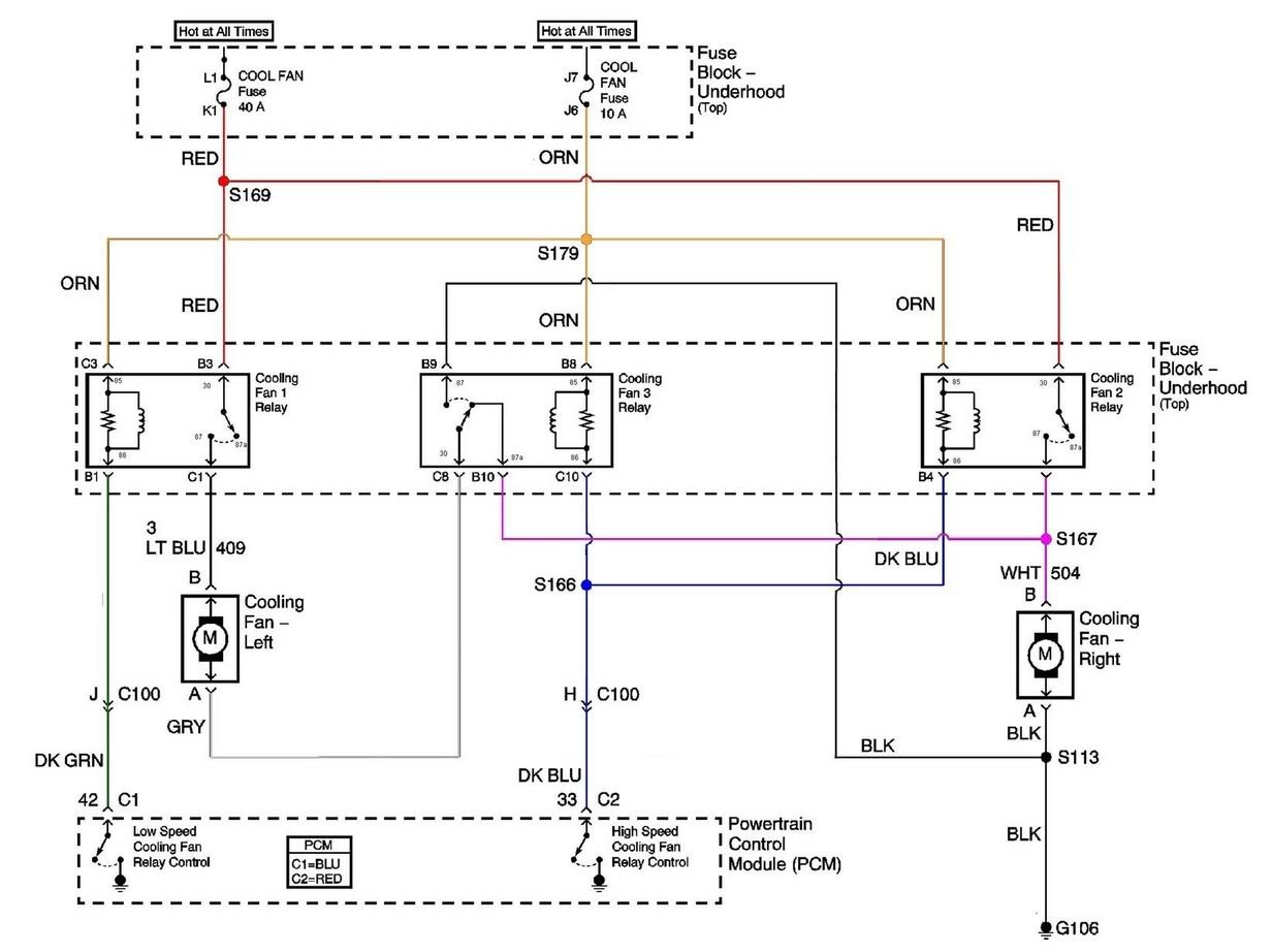

best wiring diagram to follow? i have ls1 fans here but havent installed them. Not paying 100 bucks for a harness to burn up on me.
Ive never burnt a relay or had a single problem with my LS1 efans or 05 fans.
I built a harness off that diagram using 10ga Hi-temp wire for the main wires and 14ga wire for the signal wires.
I also didnt use the AC Clutch as a "switch" it cycling off and on will do a number to a relay. Let your PCM control the fans, and put 2 override switchs in the cab.

This schematic that Atomic has posted a number of times is the traditional two pin harness. Its what I run.
