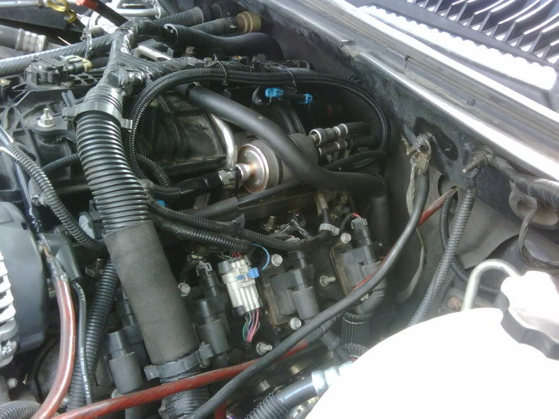

Originally Posted by 007gmc
8 ev6 fuel injector clips the factory injectors for our trucks are to short for this manifold and use multecII clips.
Not true. I'm using the regular 8.1L injectors on my TBSS intake with the TBSS rail and they are the same size. I have the TBSS injectors but didn't want to have to change the connectors.
I used the TBSS fuel rails and a corvette fuel filter to deal with the return and fpr since I didn't know where to buy or want to make a new crossover.
