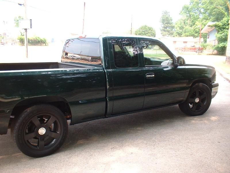

Finally got some pics of the truck. Ill take some better ones when I get around to it.
