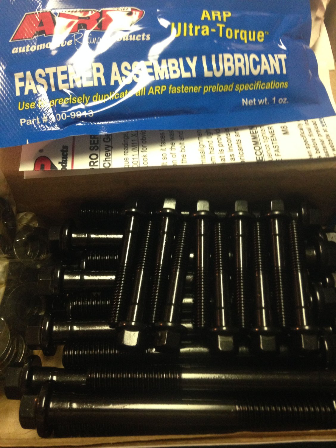

Old Jun 7, 2017 | 07:06 PM
  #42
Novicebuilder's Avatar
Joined: Jun 2017
Posts: 75
Likes: 6
From: East Texas
Got these bad boys in today
