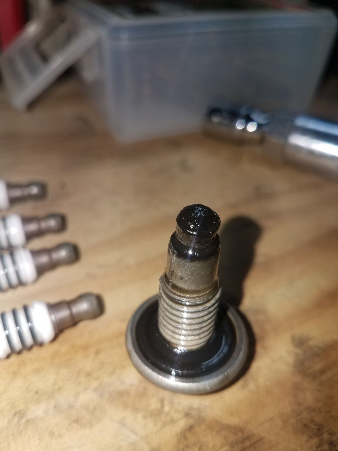

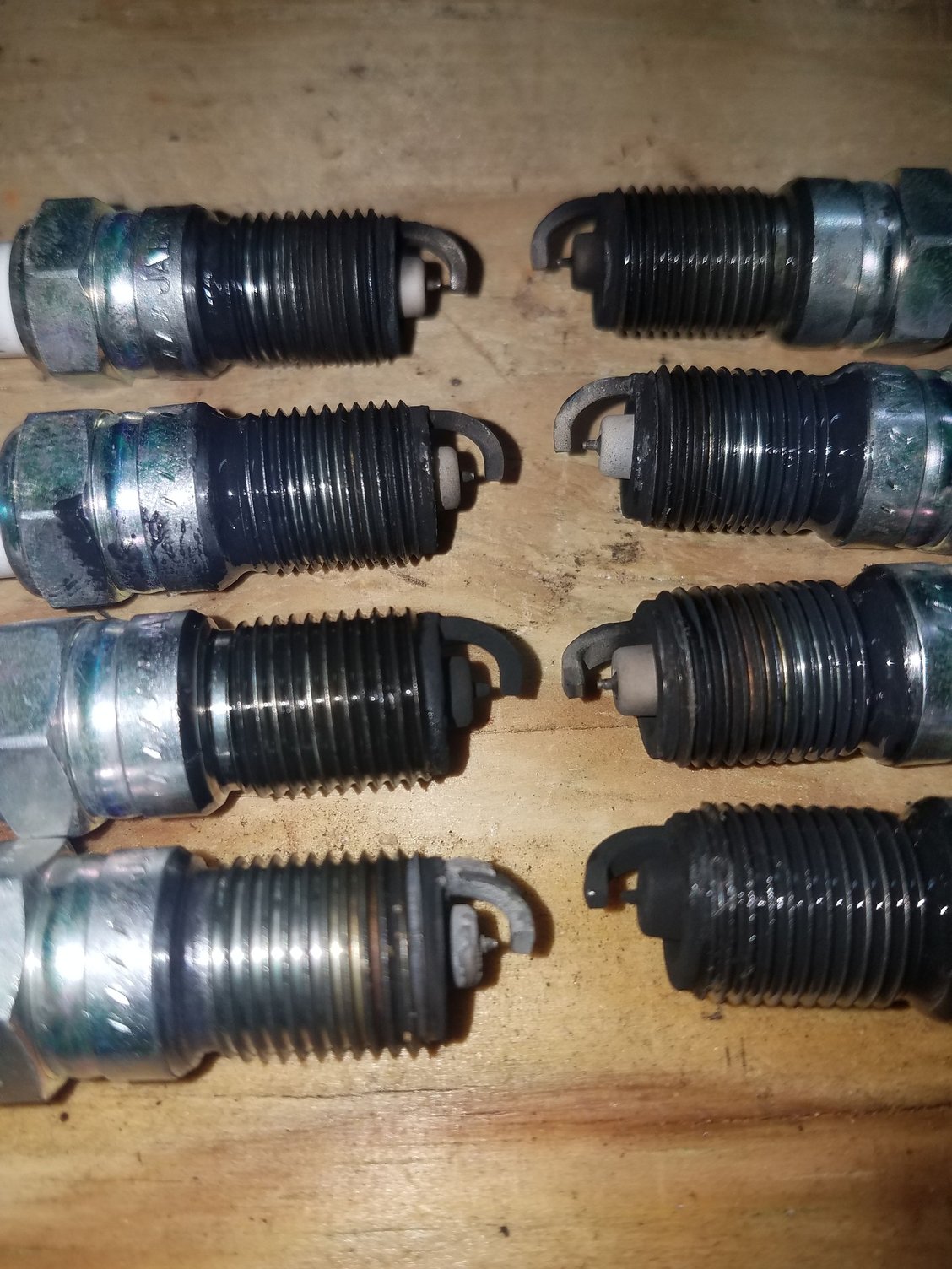

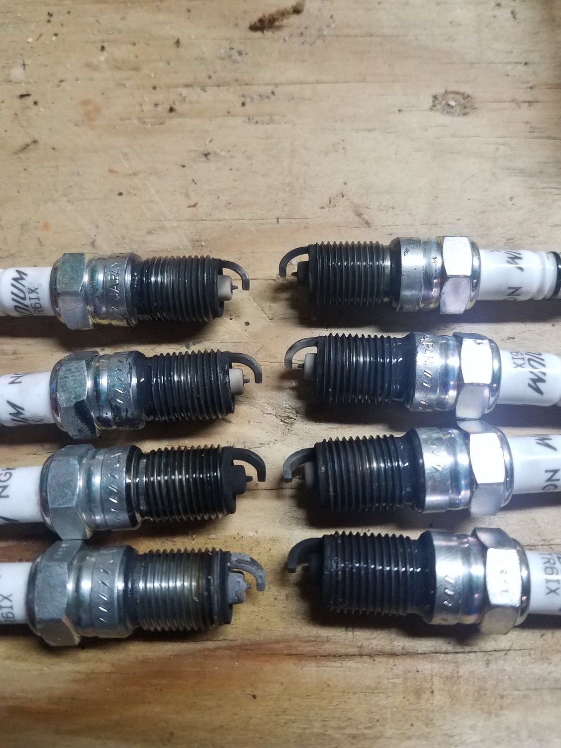

Pulled plugs, drained oil and borescope the cylinders. Plugs are to my surprise all intact as are the pistons. I saw no damage. Oil looked okay drain plug had very little fuzz compared to what I had imagined. No chunks in oil filter either.

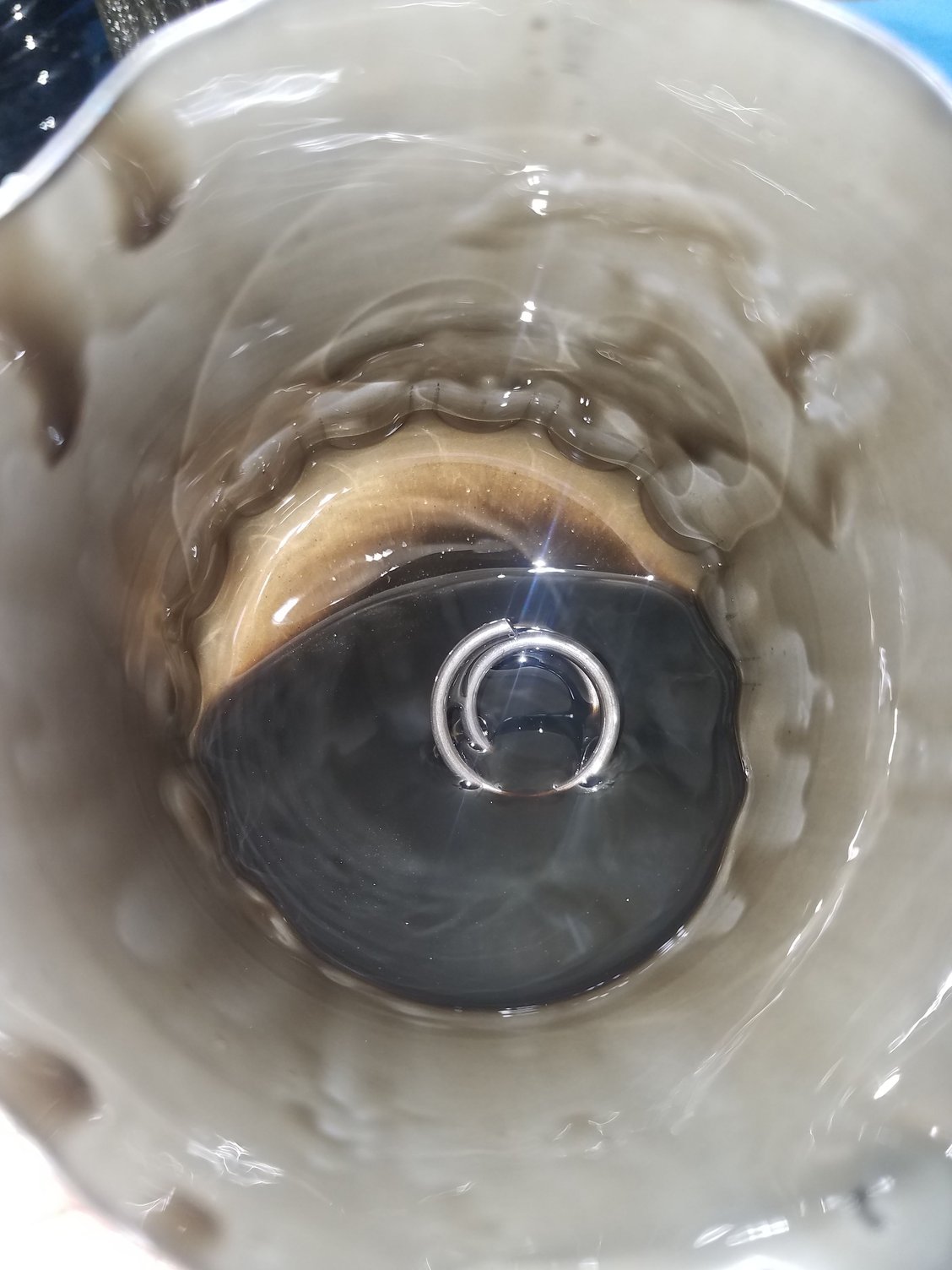

I do see some glitter in the bottom of the oil filter though.
I like to take a flash light and look at the oil I drained out. The oil you drained into a pan, hit it with a flash light and look for a river of glitter.

I did and it has a little sparkle but nothing more than it did on the first oil change. (Of course the bearings probably been dying since the first startup)
