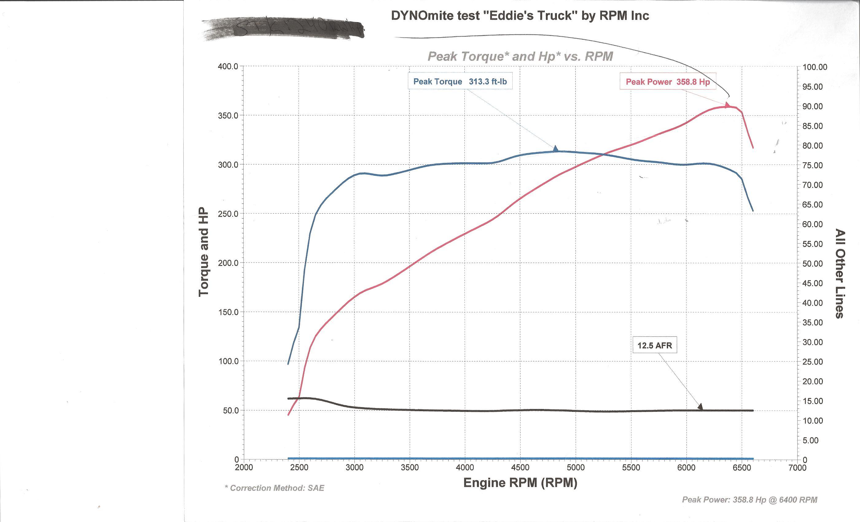

Heres my dyno sheet, this is with custom grind cam and springs, long tubes, high flow cats and cold air only. My tuner dude said the stock converter would not stay locked up when he did dyno run. hope this helps.. G.L.

Thanks for the quick reply.
What are the specs on your cam?

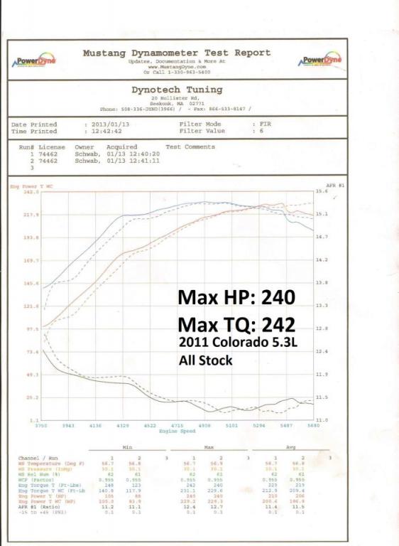

Default Gen 4 stock
this motor is rated 300hp by Chevy, it has the new 243 heads. a cam, headers, CAI and a tune 400hp easy
