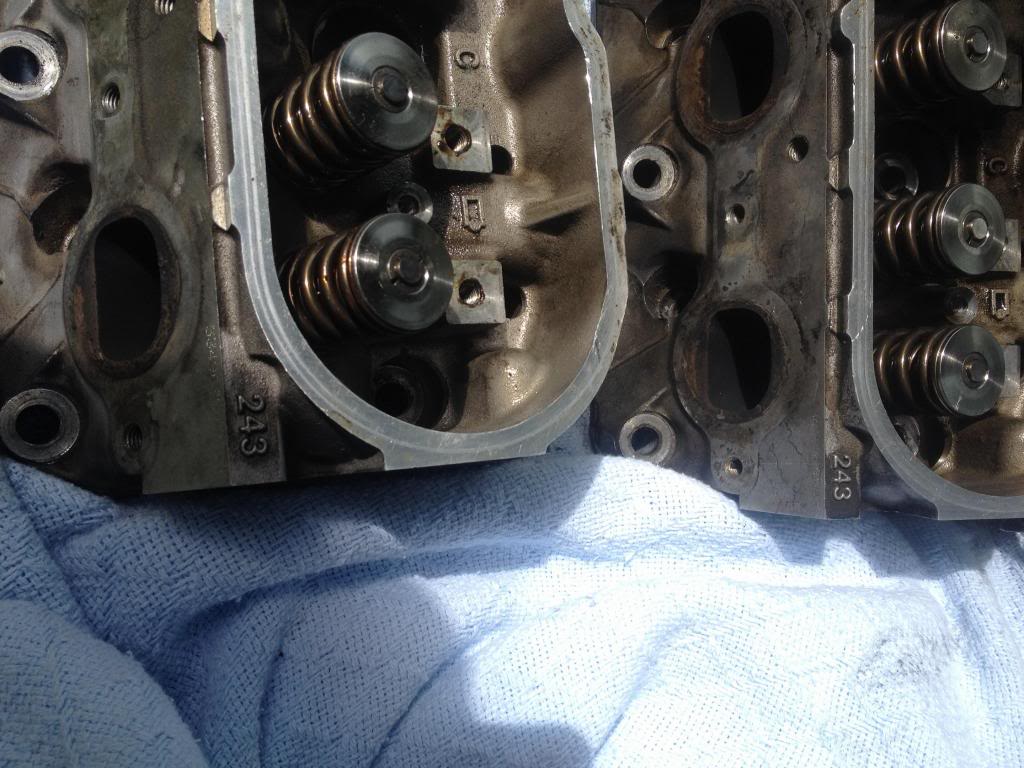

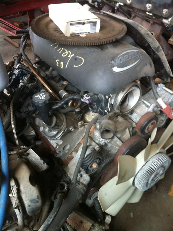

I would like for you guys to check my specs on my 6.0L build in my 2013 GMC truck. I plan on using a stock LQ4 bottom in with the 243 heads plus use the stock LQ4 intake manifold and a 90mm TB. The heads will be hand ported plus milled .030 or .035 because im shooting for around 11.2:1 to 11.5:1 comp with a MLS gasket. while the heads are getting a valve job they will also be getting bigger valves because one of the stock intake valves looks bad off. i will check for pushrod length just to make sure i order the right size. This is the cam i plan on using JEGS Performance Products 200582 JEGS Hydraulic Roller Cams - Free Shipping on All Orders @ JEGS with PRC dual spring kit and stock rocker arms. The piston to valve will also be checked to make sure im not getting to close. im sure i left something out but am i off to a good start?
This is the truck, LQ4 and 243 heads as i know everybody loves pics

You do know about the difference in knock sensor locations, reluctor wheels, etc in the Gen IV vs Gen III, right?
Old Jun 28, 2014 | 08:44 PM
GWEE's Avatar
Posts: 362
Yes sir i do... I have a LQ4 which is Gen III im putting in my truck.
Old Jun 28, 2014 | 08:57 PM
Blk09Chevy's Avatar
Joined: Nov 2012
Posts: 82
Are you changing the crank for the 54x reluctor so it will work?
Old Jun 28, 2014 | 09:08 PM
GWEE's Avatar
Posts: 362
No sir the bottom end will stay stock. i have the computer, wire harness, motor mounts, intake exhaust ect ect from a 03 2500 truck. The only thing i was going to change out was the heads, cam and TB. Is there something im missing if so please tell me so i can look into it more. Thanks
Old Jun 28, 2014 | 09:16 PM
pewterliftedz's Avatar
Joined: Nov 2008
Posts: 1,691
From: Houston
Yah good luck with that. You need to change the reluctor wheel out in order to get that motor to run in your truck, along with relocating the knock sensors to the side of the block. I'm not sure you've done your research on this swap. Or are you planning to swap wiring harness/computers out? Then idk how you will get the ECM to talk to the BCM. Goodluck
Old Jun 28, 2014 | 09:26 PM
GWEE's Avatar
Posts: 362
If i change the harness and computer out it still wont work? So it would be best to find an older truck like a 03-05 to put this in?
Old Jun 28, 2014 | 09:51 PM
Blk09Chevy's Avatar
Joined: Nov 2012
Posts: 82
99-07 nbs have the 24 reluctor wheel. all the newer 07+ have 54 reluctor wheel it will work in and older truck but not yours unless you plan on swapping out cranks but you might as well get an ly6 and have a plug and play engine that you still could use the heads on
Old Jun 28, 2014 | 09:57 PM
GWEE's Avatar
Posts: 362
Ok thanks for the heads up. I thought if i used the harness and computer from the LQ4 it would work in my nnbs. Again thanks
