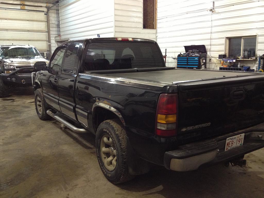

I have the opportunity to buy my sisters BF 1999 chev 1500 for $1000. Has 291,000 km with rust on the wheel wells and cab corners. He also thinks the head gaskets are done. With it running and playing with the throttle it sounds like bubbling in the coolant tank from in the cab. Is the truck worth fixing or should I not even bother? Also how are these trans? The oil is kinda burnt probley needs a service he hasn't had any problems with it though. Thanks

What do you want to do with it?Sounds like it needs an engine and the 4L60E is on its way to its usual early demise.I would likely grab it for that money,I have seen far worse trucks go for more than twice that around these parts,worse case scenario you can part it out and maybe triple your money.

That looks like a good truck for 1g , I'd buy it.

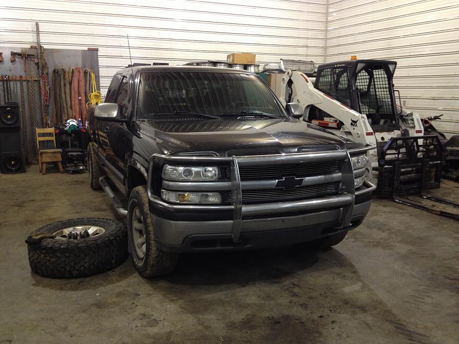

Another photo
