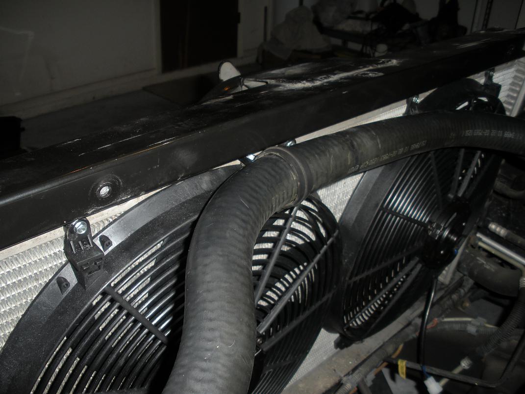

03 5.3 efans question-e-fans9.jpgi just did the exact same thing to the caddy and works flawless(so far lol!) i used 2 pro-comp(a knock off of something I'm sure) 16'' fans and a nelson harness. like the other guy said, use the biggest fans you can- my fans only have about 1/2'' in between them and on either side and only miss about 3/4''-1'' at the bottom practically covers entire radiator. main reason i did this instead of factory fans is more room in front of the motor. I'm totally with the people that say you get what you pay for, but i only paid $50 bucks for them and i dont think they will both go bad ad the same time.

Absolutely...You want the Flexalite #298...which are dual 13 1/2" fans mounted in a shroud (28")..the shroud makes sure the air gets pulled over all of the surface area of the radiator and helps avoid "hotspots" ..
