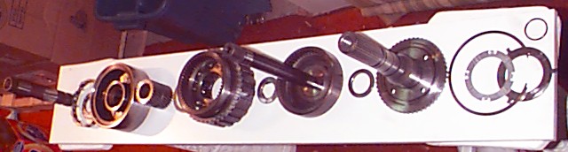

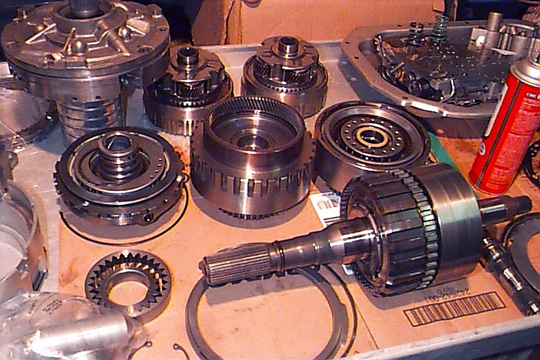

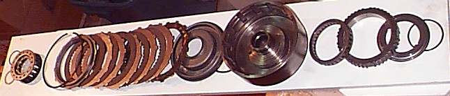

I did it. It doesn't need any specialized tools. The Overdrive piston is difficult to get back together while trying to protect the piston seals. For that I used overhead tansparencies cut into strips. I used sockets to pound out the old bushings and to install the new ones. The piston springs can be compressed in a vise to get the snaprings back in. It really is easy.
If you get stuck I can help. I took pictures of every part when I disassembled mine and named them after the number in the ATSG manual for the 4L80-E.
My 80 is still going strong.

I spent a total of about 40 hours on it. That includes meticulously cleaning, identifying and photographing every single part. I could really do it much faster now, but not having ever opened an automatic transmission prior to that I wanted to make sure I knew what goes where and could not make mistakes in re-assembly. All sub-assemblies were laid out in the order they came apart. When I put it back together I checked all tollerances against the information given in the book. The unit I bought was pulled from a 2000 truck with 100k and change on it. The bushing in the forward drum was spun. The whole drum had to be replaced. I also upgraded the sprag and the overdrive roller clutch assembly to newer spec parts. Other than that it's got a rebuild kit from Level Ten Performance. All the clutches are Raybestos except the Overdrive. Raybestos wasn't making the OD clutches yet at the time. It's got a TransGo shift kit and a B&M pan. No exotic laundry list of hard parts at all! These things just WORK.
