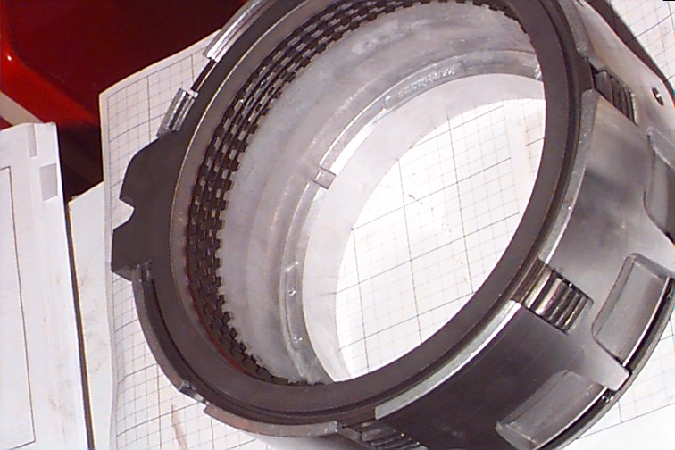

It seemed like I fell down the rabbit hole when I saw this pic....

I just checked out Hughes Performance Transmission they have Alto Red Eagle and Kolene Steels for the Fourth clutch and Overrun (they are not technical called Alto Red Eagle but they are). This wants me to go out and start pulling the tranny out of my truck and rebuild it.
