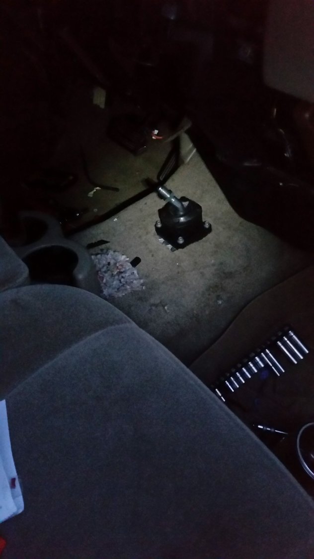

The shifter came out good. That's in. The driveshaft has been ordered and should ship today. I cut the hole in the firewall for the pedal bracket. That wen't well. I test fit the bracket in there. It's tight! I'm only going to use the two holes on the bracket. I know it's going to be frowned upon but I don't think it'll be a problem. I think I could shove the bracket in there and hook it up without any bolts and it would work. That's how tight it fits in there. I almost couldn't get it back out. Now, once I get my nut strip and install the pedal, I only have one major problem. My y pipe doesn't fit under the transmission. I carelessly overlooked that when considering the cost of this swap. I'm going to have to go get some exhaust work done. That's going to set me back.

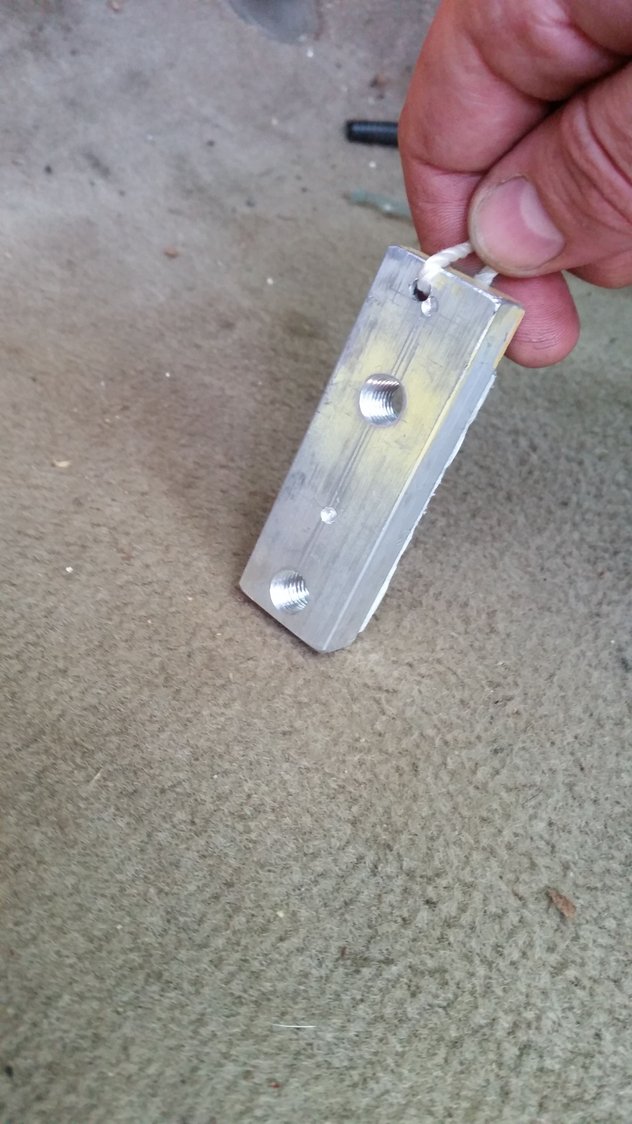

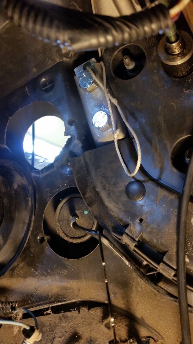

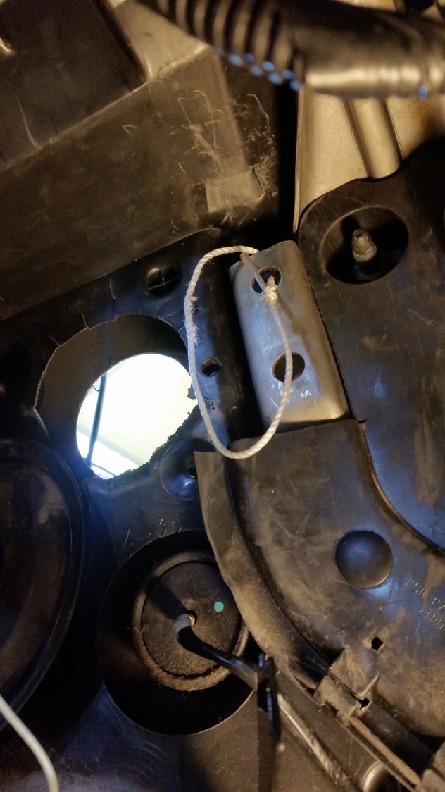

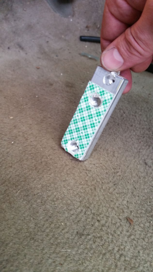

I made my nut strip out of 1/2" x 1" aluminum bar stock. I took a 3" piece and drill and tapped it to m10x1.5. I drilled an extra hole at the top and tied a piece of twine to it. Then I put that thick two sided tape on the front of it. I had to cut a slit in the plastic above where it slides in because it would have to bend to slide in the top of that bracket. So I forced it in and held the string so that I could start the bolts to pull the strip forward so the tape would stick to the bracket. Here are a couple of pics to try to explain:

that will save a lot of work if it pans out!

The bracket seems to work fine. How did you deal with your exhaust? Did you have a custom y-pipe made? Does it cross under the transmission or after the crossmember?
