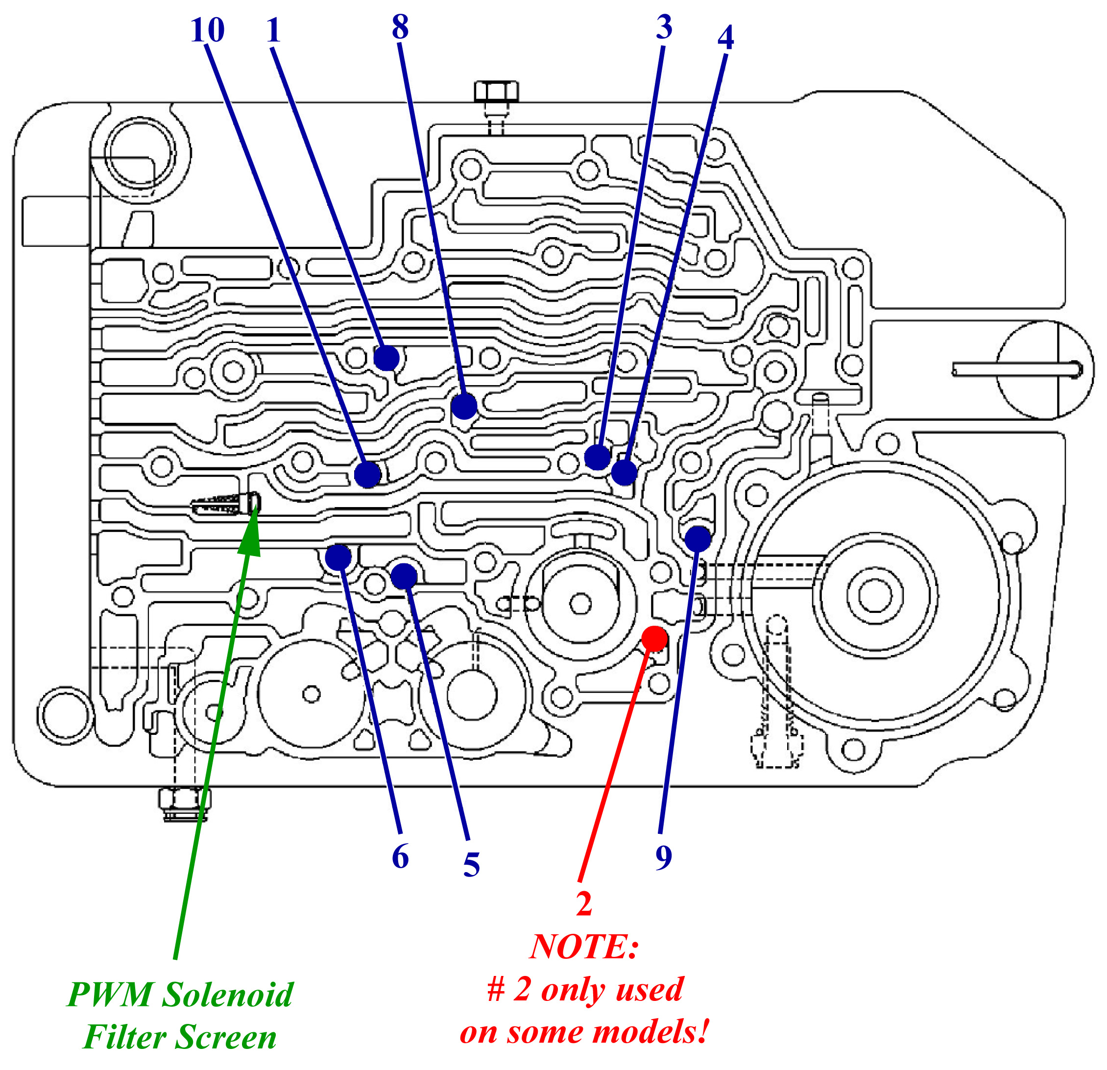

My 2-3 is nearly identical to my 1-2 at wot. Fast and firm. What size did you guys drill your 2-3 hole to? I didn't drill 2-3, just left the check ball out per Jakes recommendation.
What checkball is that? Perhaps thats the difference here.
I have all 8 blue marked ones. Which did you leave out?
Who installed their 80e Transgo HD2 without doing the pump mods?-y9pwjmy.jpg

4L80E / Transgo HD2 guys, what did you drill to? - LS1TECH
".108-.125 for the 2nd feed, don't drill 3rd, just leave the checkball out at that location, and .125 for 4th feed."
I honestly couldn't pinpoint which one it is on the above image.

For the records, it looks like #8 is the one being suggested to leave out.
Who installed their 80e Transgo HD2 without doing the pump mods?-rwhnrrk.gif
From here:
https://www.performancetrucks.net/fo...-506779/page6/
Slow67 knows his stuff it seems! Is the cup plug added to the case the "I like to block the 3rd accumulator" portion Slow67 talks about?
"I like to block the 3rd accumulator and leave out the 3rd checkball. Still has a controllable 2-3 shift, but still shifts firm at WOT.
When dual feeding 3rd, and drilling the bleed hole, you need a lot more fluid to fill it, and a constant supply (due to the bleed hole).
"Yes, #8 checkball."
